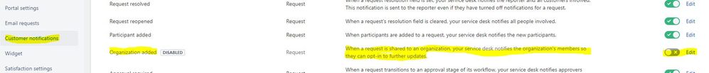

I solved my own problem - just posting the answer if anyone else run's into it.
Obviously the 'Notification Scheme' was configured how we wanted it, i just hadn't modified the 'Customer Notifications' in the specific project itself;
Once i disabled this option, it stopped sending notifications to the whole organization.
