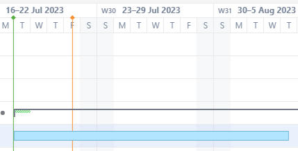

If you want to avoid using manual scheduling for tasks altogether and keep their dates flexible, you can do something like this:
The milestone's position on the chart will be manually scheduled so you'll be able to move it where needed. The dependency will in turn move the task along on the chart while the task will be scheduled fully automatically. All tasks that have dependencies from that task will also be automatically rescheduled to reflect the change.
The tricky part here is the 3 days off that the assignee took. Time off should be defined in the resource's Availability settings and you would need to extend the Fix.duration parameter to 13d. Then you will get the result you need - the finish date of the task will automatically add 3 days, the resource allocation will reflect the capacity - 1h per day with 3 days of having 0 work done, and all dependent tasks will be rescheduled to a later time automatically as well.

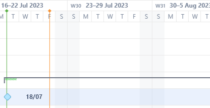

I can't seem to create a milestone and then create a dependency between that and the task. It doesn't allow it.
Am I missing something?
The Milestone replaces the tasks bar and the milestone doesn't have a start and finish date, just a date.
A milestone is based on an issue in Jira, so if you want to have a task with a dependency to a milestone, you need to have two issues in your structure - one will be the task, and the other will be turned into a milestone.
If you have more questions, please submit a support request at our portal since we'll need to take a closer look at your setup.
