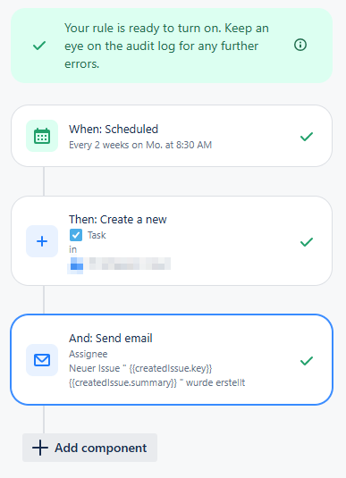

Hi all,
I'm kind of stuck and can't see the error.
The automation is set up like:
- trigger every two weeks
- creat new Task Issue
- send notification to assignee
But the Audit Log shows an error at the last step sending the notification mail, as no issue is present so it can not get the assignee. BUT the issue has been created correctly
Why isn't it getting the just created issue and assignee of it?
The new Task issue is existing and I got assigned in it, but I never got any notification about it.
Somehow I should generally get a notification when a newly created issue is assigned to me I think. At least that was the case so far and we have not actively changed anything.
The solution looks like this:

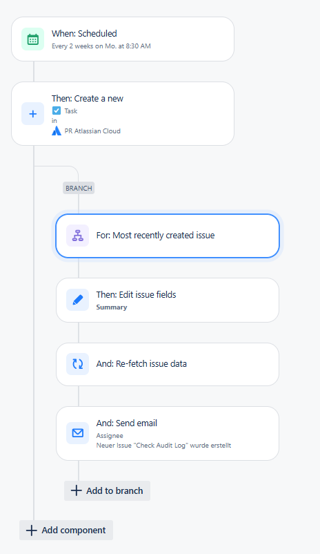

Hi @Martin Flury , try adding a re-fetch data action before sending the email? This often times fix similar issues where there is a race condition.
Martin Flury
February 6, 2025
Hi @Jack Brickey
I implemented the solution from Bill, which solved my missing email problem.
After adding the "Edit issue fields" action your solution helped me adding this new values to my new email in the step afterwards.
So thank you very much for your help as well.
Bill Sheboy
January 31, 2025
Hi @Martin Flury
Your rule image shows using the Assignee for the Send Email action, but there is no issue within scope at that point in the rule.
The fix is to add a branch to most-recently-created-issue before the email action:
  • trigger: scheduled
  • action: create issue for the task
  • branch: to most recently created issue
    • action: send email, changing your email body to now reference {{issue.key}} and {{issue.summary}}
Another way to solve this would be to use the smart value for the email address rather than selecting Assignee from the dropdown in the To field: {{createdIssue.assignee.emailAddress}}

Martin Flury
February 6, 2025
@Bill Sheboy you nailed it.
Adding the branch did solve my missing email problem.
After that I got every mail.
Thanks again for your help. Appreciate it.

Martin Flury
February 6, 2025
I have to admit I'm a greenhorn in Jira automation and the usage of smart values is definitely not one of my strengths.
In this case the adding of a branch solved my original problem and my secondly created problem, having access to the edited field values for the mail, got solved with the re-fetch.
