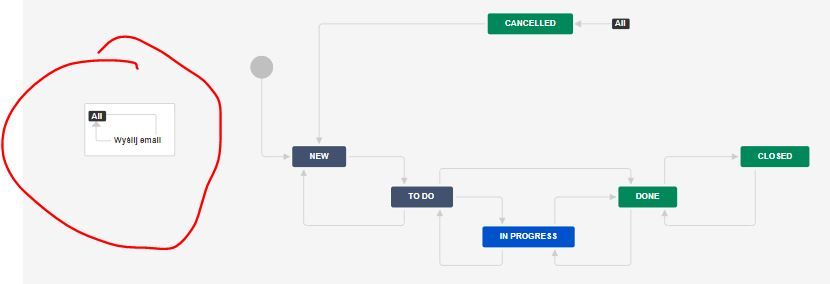

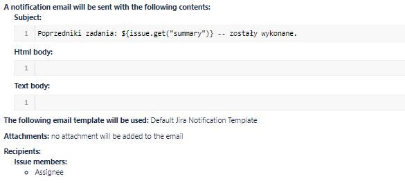

I set up a 'Task' transition for workflow and it should work like this:
 If all tasks related to the current task are closed/resolved/done then send an e-mail notification to the user assigned to the task which is related.
Conditions:
Post function:
And now:
Task test-1 is related to task test-2 (connection: has to be done after).
So, when I close task-1, I should receive an email notification as a user assigned to task-2.
Unfortunately, it does not work;/
Does anyone have a similar problem or maybe know the solution?

Hi @A_lis
You want the email will be sent automatically when all related tasks are done?
If yes, you  did it wrong.
What you did is a transition, that once you click on it (in the issue view) it will check if all related issues are done, and if yes, it will send email... so the email is based on your action to click the transition button, it will not happen automatically in Task 1 while Task 2 is completed.
You need a completely another way of doing this.
I suggest plugins like ScriptRunner or Automation for Jira
