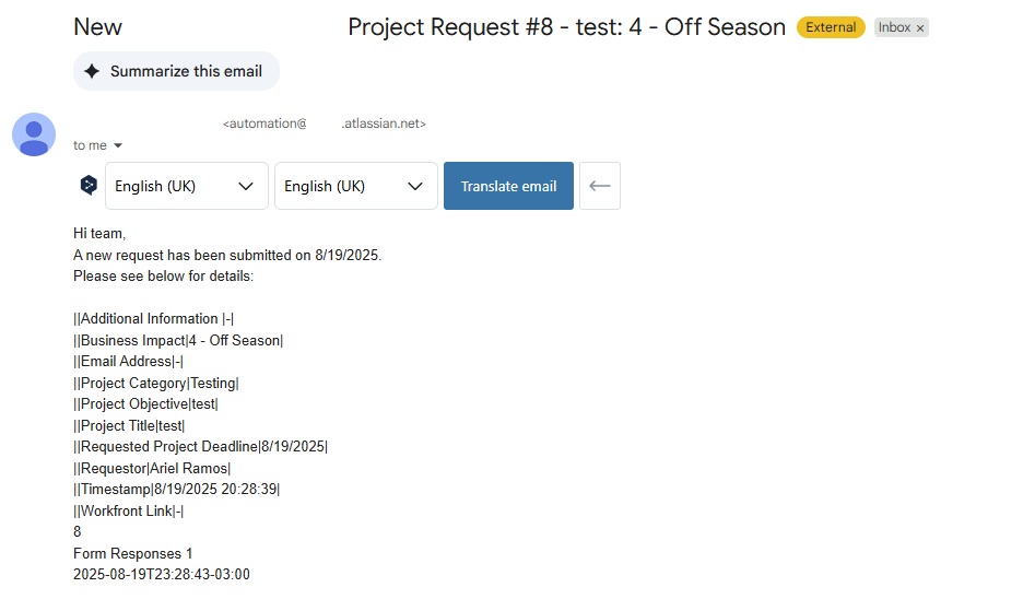

I need your expertise with a setup issue. I have two team-managed Jira projects, each linked to a different Google Form. Both are set up with an automation rule to create a Jira issue when the form is submitted, and that part works great.
The problem is that Project #1 sends a beautifully formatted email notification to a distribution list every time a new issue is created (see the first screenshot).

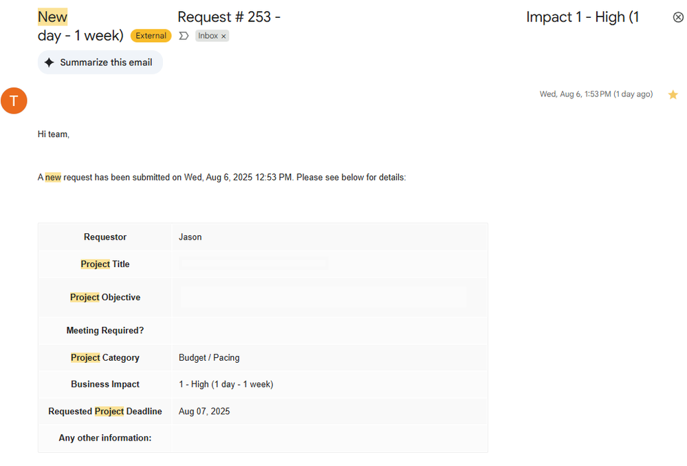

I've dug into Jira's automation rules, notifications, and even the Google Apps Script code, but I can't find where this email is coming from. My guess is that an ex employee might have set it up with something like Zapier.
I need Project #2 to send an email with the exact same format, but when I try to configure it, the email comes out as plain text instead (see the second screenshot).
Do you know how I can set up Project #2 to send a formatted email like Project #1 does?

By default, the “Send email” action in Jira Automation is pretty limited (plain text or very simple formatting). If your first project is sending a polished HTML email, it’s likely powered by a legacy Zapier setup, Apps Script, or an old integration someone built before.
Quick Fix: Improve Your Jira Automation Email
Your current automation is probably sending plain text emails. You can make them look much better by adding some simple HTML formatting:
  1. Go to Project Settings → Automation in Project #2
  2. Find your existing rule for form submissions
  3. Edit the "Send email" action and use this template:
<h3>🎯 New Request Submitted</h3>
<p><strong>From:</strong> {{issue.reporter.displayName}}</p>
<p><strong>Subject:</strong> {{issue.summary}}</p>
<p><strong>Details:</strong><br>{{issue.description}}</p>
<p><strong>Priority:</strong> {{issue.priority.name}}</p>
<hr>
<p><a href="{{issue.url}}" style="color: #0052CC;">👉 View Ticket in Jira</a></p>
This will give you formatted emails with headers, bold text, and clickable links - much closer to what Project #1 is sending.

The email that you received for the Project 2 request is different because the automation is configured using plain text formatting instead of HTML i think. That’s why it doesn’t mirror the table layout from the other project.
I’ve provided an HTML template (based on your Project 2 email screenshot) that you can use. To adapt it, just replace the placeholder ({{issue.customfield_XXXX}}) custom field IDs with your actual smart values or custom field ids between the <td></td> tags for each field. Then, paste the updated HTML into the “Send email” action content.

A couple of key points to check in the Send email action:
  • Expand the More options at the bottom and select “Send as HTML.”
  • Uncheck “Convert line breaks to HTML line breaks.”
Once this is done, the email should closely mirror the format of the first one.
If you run into difficulties, feel free to share the exact email content you’re currently using for the project 2 email — I can help refine the HTML with the correct custom field IDs for you.
