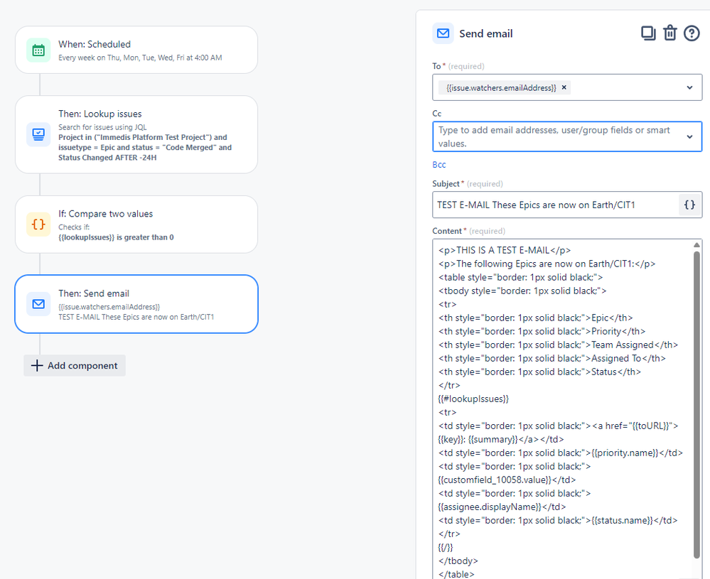

I want to send an email to people who have chosen to watch certain issues and to notify them when the issues reach a certain status.
I am using this structure:

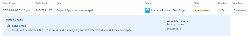

If this {{issue.watchers.emailAddress}} returns the watcher's email address shouldn't that rule send an email to all watchers by putting this smart value in the email address line. I also tried {{#issue.watchers.emailAddress}}{{/}}.
I get an error and no e-mails are sent over. The rule returns at least 1 item and I made sure that I am added as a watcher.

Hi @Artur Balyan _ Immedis,
You are using {{lookupIssues}} to retrieve multiple issues and then use {{issue.watchers.emailAddress}} as a smart value to retrieve the To email address(es), but you have not specified / initiated an issue in your rule. That is why there is no email address found.
You could retrieve a list of unique email addresses through a lookup Issues action and then add a branch to your rule For each / Smart value, sending the email to each email address.
Adding to the other suggestions offered...
The watchers field is a list of users, and when this smart value expression is used in the Send Email action's To field:
By default, it joins them with commas.  However, the Send Email action uses a semicolon delimiter between email addresses.  To solve this, please select that specifically with the join() function instead:
{{issue.watchers.emailAddress.join("; ")}}
