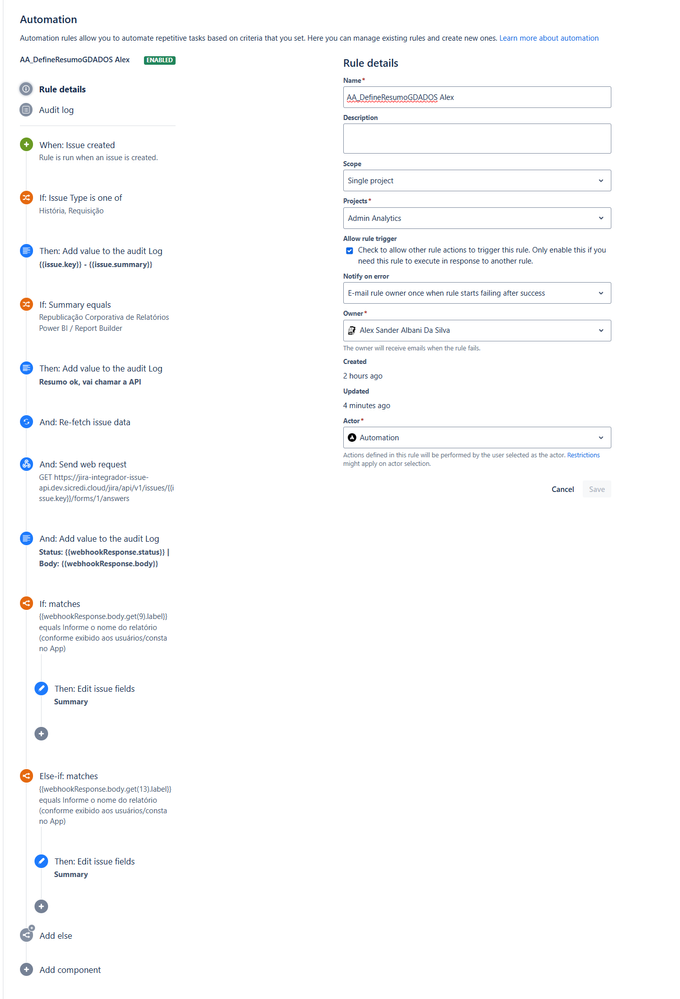

This is the rule:

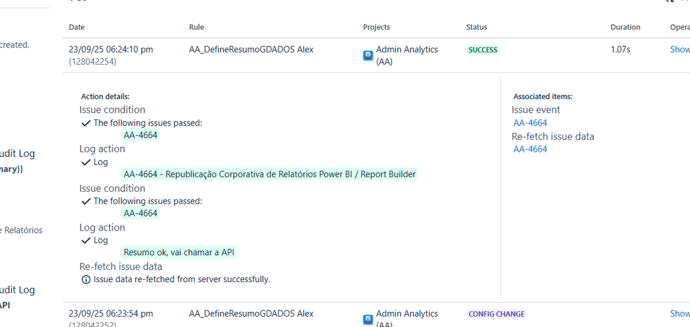

This is the execution log when a issue is created and the rule triggered. Note that it stops in the "Re-fetch issue data":

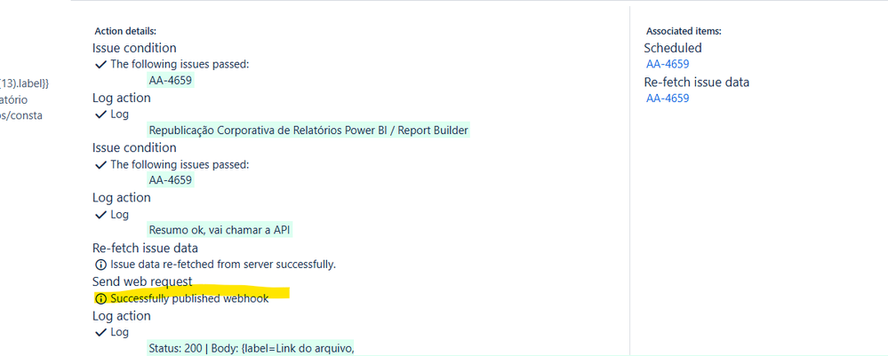

And this is an exemple of log with the same steps, with a trigger other than "issue created". In this case the trigger was a Schedule and the web request was raised:

Hi @Alex Sander Albani da Silva -- Welcome to the Atlassian Community!
For a question like this, context is important for the community to help.  Please post the following:
  • What version of Jira are you using: Cloud, Server, or Data Center?  Your question states Data Center but is tagged as as Jira Cloud.
  • An image of your complete automation rule in a single image for continuity
  • Images of any relevant actions / conditions / branches
  • An image of the audit log details showing the rule execution

I added more information and images to clarify the situation.

First, please move the Re-fetch Issue Data action to immediately after the Issue Created trigger.  That will help mitigate if there are any timing problems where the rule starts before all the data is ready / available for the remaining steps.
Next, in your Send Web Request action, did you select the option so the processing pauses until the call returns?
