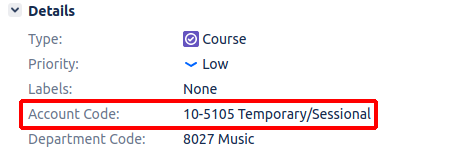

I am having an unusual issue where we have a workflow transition that brings up a screen with some of the fields of the issue on it for modification.  One (and only one) of the fields on that screen is a select list, but when you go to 'edit' the field, it comes up with a different one than is set on the issue.  specifically, it comes up with the first option in the list after 'None'.
Here are a couple of screenshots:
First, the issue view:
Then when we bring up a custom 'edit' screen prepopulated with the existing values:

Hi @jdohms,
Do you have any Scriptrunner Behaviour or any Javascript injected in the Announcement Banner? These sorts of values are easily manipulated on the front-end, hence it would be a good start to look at them first.
  1. To rule out any web browser related cause, you can use a different web browser.
  2. To rule out any installed third-party apps, you can enable Safe Mode on Jira.
  3. Take a look at the Jira's Announcement Banner content.

Brilliant.  Thank you so much.  There was a Scriptrunner Behaviour changing the field value.  I didn't build this project, so I am still discovering all the bits and pieces involved.
