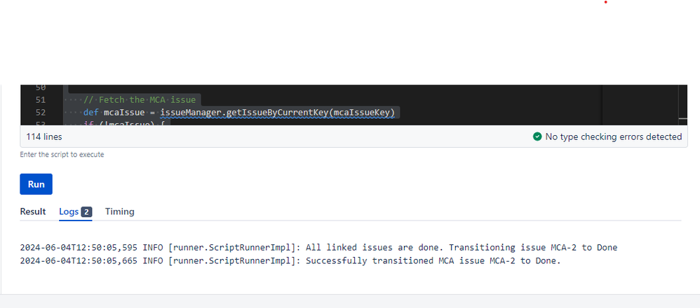

How can I automate the transition of the MCA project to the "Done" status in Jira once both the BCA and CA projects have reached the "Done" status, considering that MCA is linked to BCA and CA, using Script Runner
Current Setup: I've written a ScriptRunner script in Groovy that checks the statuses of linked issues in BCA and CA projects. If both BCA and CA are in the "Done" status, it directly transitions the MCA issue to "Done", without waiting for BCA and CA statuses?
