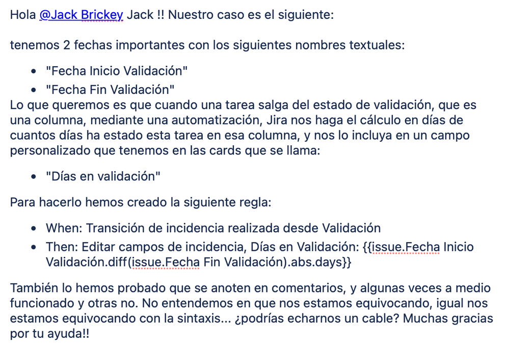

Hola @Jack Brickey te adjunto como imagen el mensaje que te quería mandar porque no me está dejando como texto:

Sorry mate, I didn't know you spoke English. I address the problem again:
Hi @Jack Brickey !!! Our case is as follows:
We have 2 important dates with the following textual names:
- "Validation Start Date"
- "Validation End Date"
What we want is that when a task leaves the validation state, which is a column, through an automation, Jira makes us the calculation in days of how many days this task has been in that column, and we include it in a custom field that we have in the cards called:
- "Days in validation".
To do this we have created the following rule:
- When: Transition of incidence made from Validation.
- Then: Edit issue fields, Days in Validation: {fissue.Start Date
Validation.diff (issue.Date End Validation).abs.days}}
We have also tested it to be noted in comments, and sometimes it half worked and sometimes it did not. We don't understand where we are going wrong, maybe we are making a mistake with the syntax.
Are we making a mistake with the syntax? could you help us? Thank you very much for your help!
Jack Brickey
February 1, 2024
Hi @Alejandra Ruiz , thank you for the translation.
You mentioned that it's sometime working and sometimes not. When it is not working, what are the details? What does the audit log show? Maybe the rule is not triggering? I would inspect closely the scenarios where it does not work and look at the history of the issue to see if there's something unique being overlooked. Maybe there are multiple transitions going in and out of the validation state.
