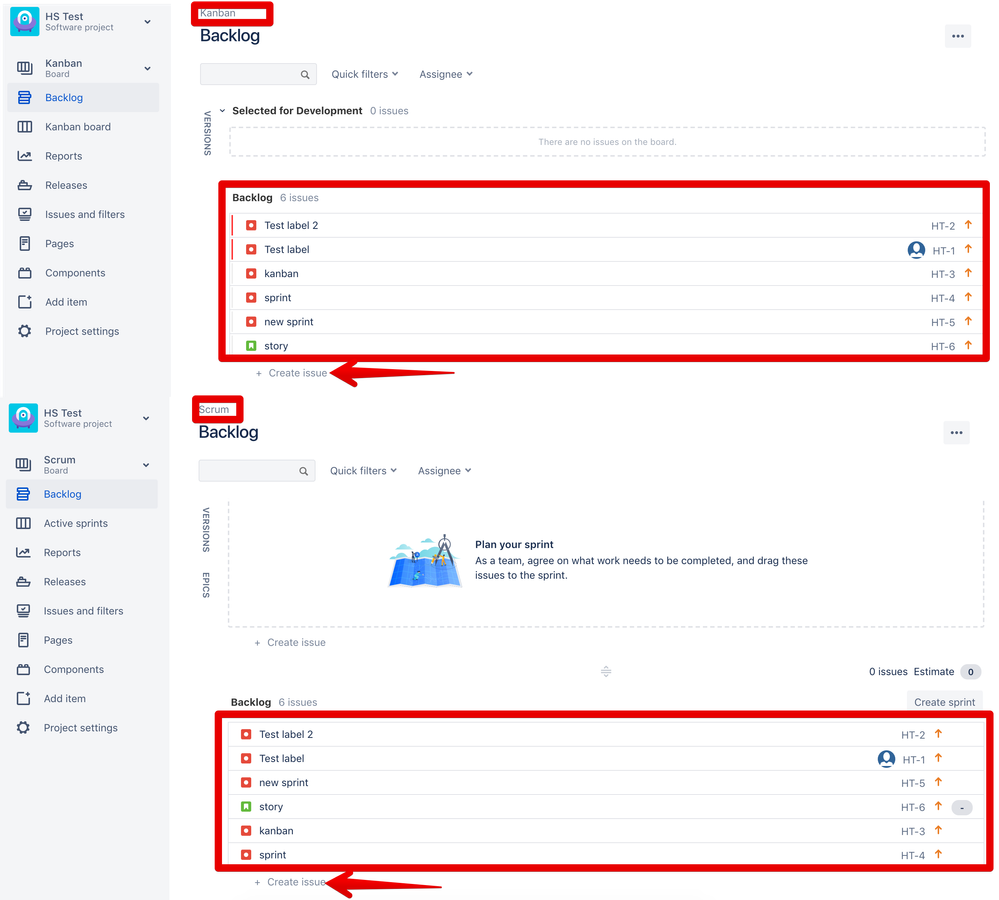

I have two boards (scrum, kanban). When I create tasks for the sprint, they are also created in the kanban backlog. I want to have a separate backlog for them. How is it possible?

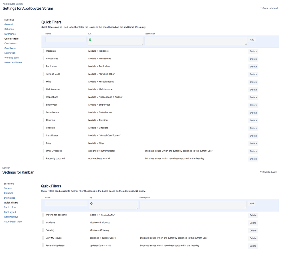

The filter for the board is in the General page.
Alexey Matveev
October 16, 2018

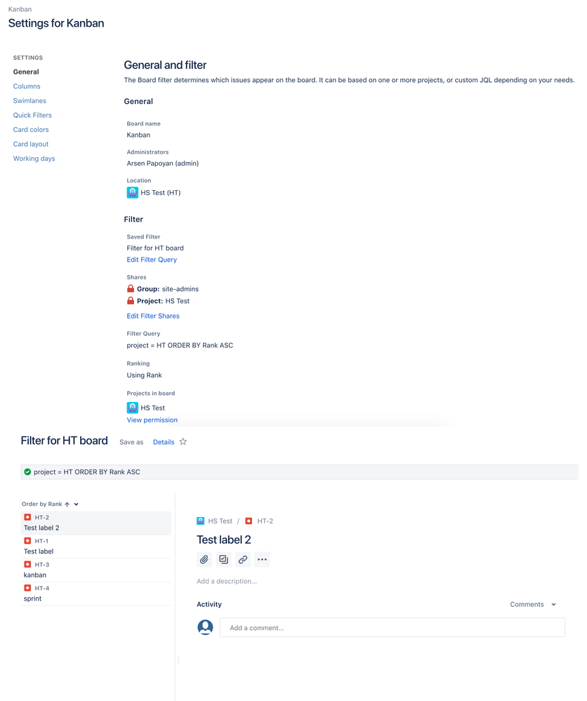

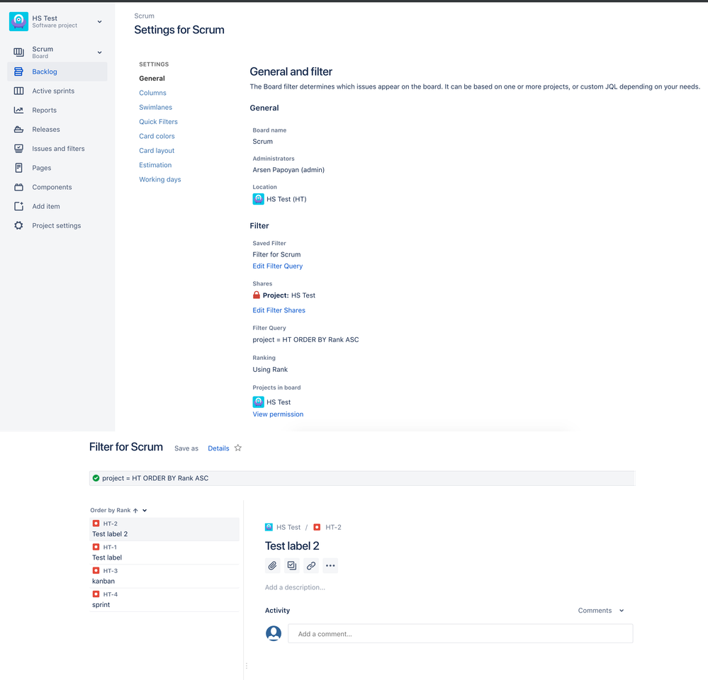

Alexey Matveev
October 16, 2018
Click on the Filter for HT board and Filter for Scurm and you will be able to see the JQL queries. Kindly paste this JQL queries here

Ok. Got it. Your JQL filter is the same for both boards. Here it is:
project = HT order by Rank asc (it is seen on your screenshot).

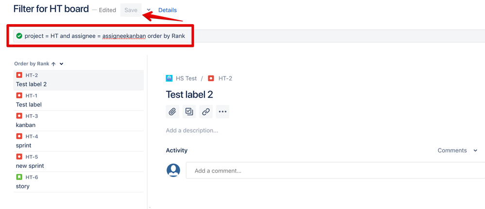

For example, if you can differ it by assignees then you should change this query like this:
For the scrum board:
project = HT and assignee = assigneescum order by Rank
For the kanban board:
project = HT and assignee = assigneekanban order by Rank
But first you need to define the condition on which you define to what board an issue belongs.

@Alexey Matveev I have tried, but the SAVE is not being active.

It will not work because you do not have such users as assigneescrum and assigneekanban.
How do you understand that an issue belongs to a scrum board or to a kanban board?

@Alexey MatveevMy problem is that I have two boards in one project (kanban, scrum). Those boards have a backlog. When I create an issue in one of the board backlog, it appears on both boards.
I want to create an issue that will only be in the current board backlog.

Issues which have been created in the kanban backlog are automatically created in the scrum board as well. Can we are not allowed this behaviour?
