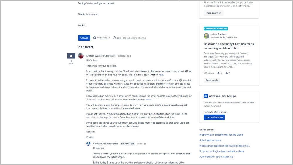

Hi Venkat,
Thank you for your question.
I can confirm that the way that Jira Cloud works is different to Jira server as there is only a rest API for the cloud version and no Java API as described in the documentation here
In order to achieve this requirement you would need to create a script which performs a JQL search in order to identify all issues which macthed the specified fix version, and then for each of those issues to loop over each issue returned and only transition the ones which match a specified issue type and status.
I have created an example of a script which can be ran on the script console inside of ScripRunner for Jira cloud to show how this can be done which is located here.
You will be able to use this script in order to show how you could create a similar script as a post function or a listiner to transition the required issues.
Please not that when executing a transition a script will only be able to transition the issue   if the transition to the required status from the current status exists inside of the workflow.
If this issue has solved your requirement can you please mark it as accepted so that other users can see it is correct when searching for similar answers.

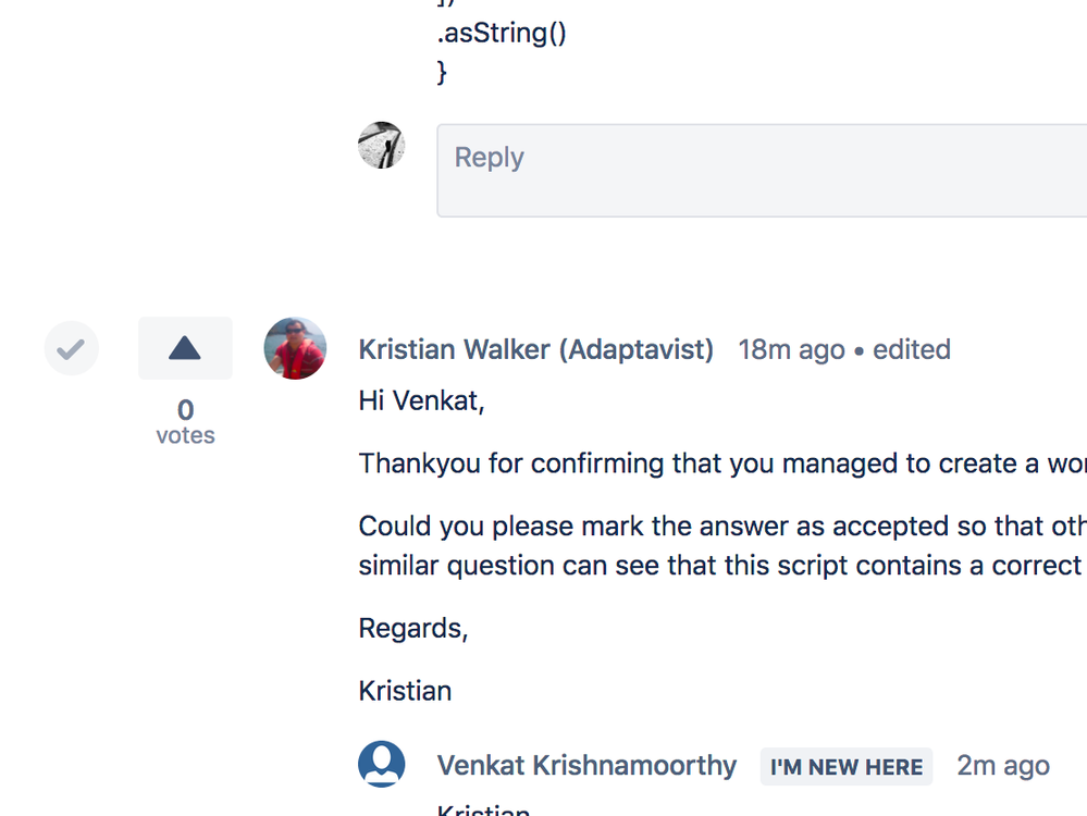

Venkat Krishnamoorthy
August 1, 2018
Kristian,
For some reason, I dont see the "Accept Solution" check mark. Please see attached.
Kristian Walker (Adaptavist)
August 1, 2018
Hi Ventak,
Normally it would be directly below the answer but I cannot see what options below the answer form your screenshot.
Kristian
August 1, 2018
In the past, when I was using different Atlassian account, I have accepted answers. It must be something to do with my current account. I dont see the check mark at all (Please see screenshot attached). This is my first post using this account.
Nic, do you mind accepting Kristian's answer?
Thanks.
