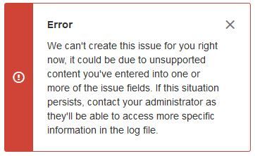

Thank for your help, the code you provided returned the error below when I tried to create an issue with it in place.
if (cfValues['Budget Department']?.value || cfValues['Project\\Program ID']?.value ) {
return true;
} else {
return false;
Mohamed Benziane

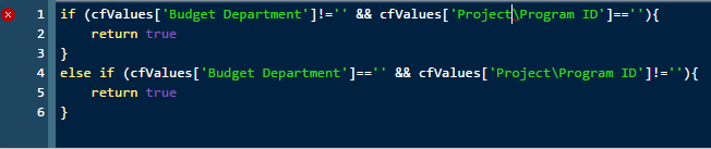

Michael Johnson
September 10, 2018
Hi Mohamed,
Here's the code I tried and it gave the error below.
if (cfValues['Budget Department']!='' && cfValues['Project\\Program ID']==''){
 return true
else if (cfValues['Budget Department']=='' && cfValues['Project\\Program ID']!=''){
 return true
else return false
