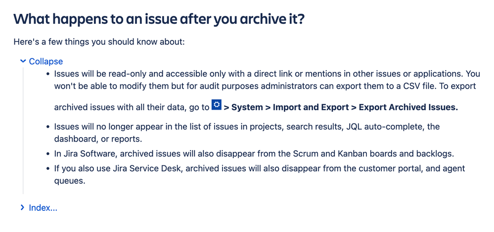

Jorge Guerreiro
January 23, 2025
Hi Marc,
I literally wrote a script to unarchive all of the issues from a project until I realised JQL does not help me on this any more. As far as I'm aware there is no way to get the archived issues with ScriptRunner.
Hope that helps
