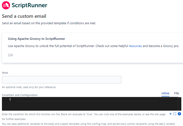

I am working on Scriptrunner post function - Send Custom Email. I am needing to have the condition be if the Request Type is either Option A, Option B, or Option C. Each thing I have tried is not working as I can't seem to figure out the operator for it to be any of those.

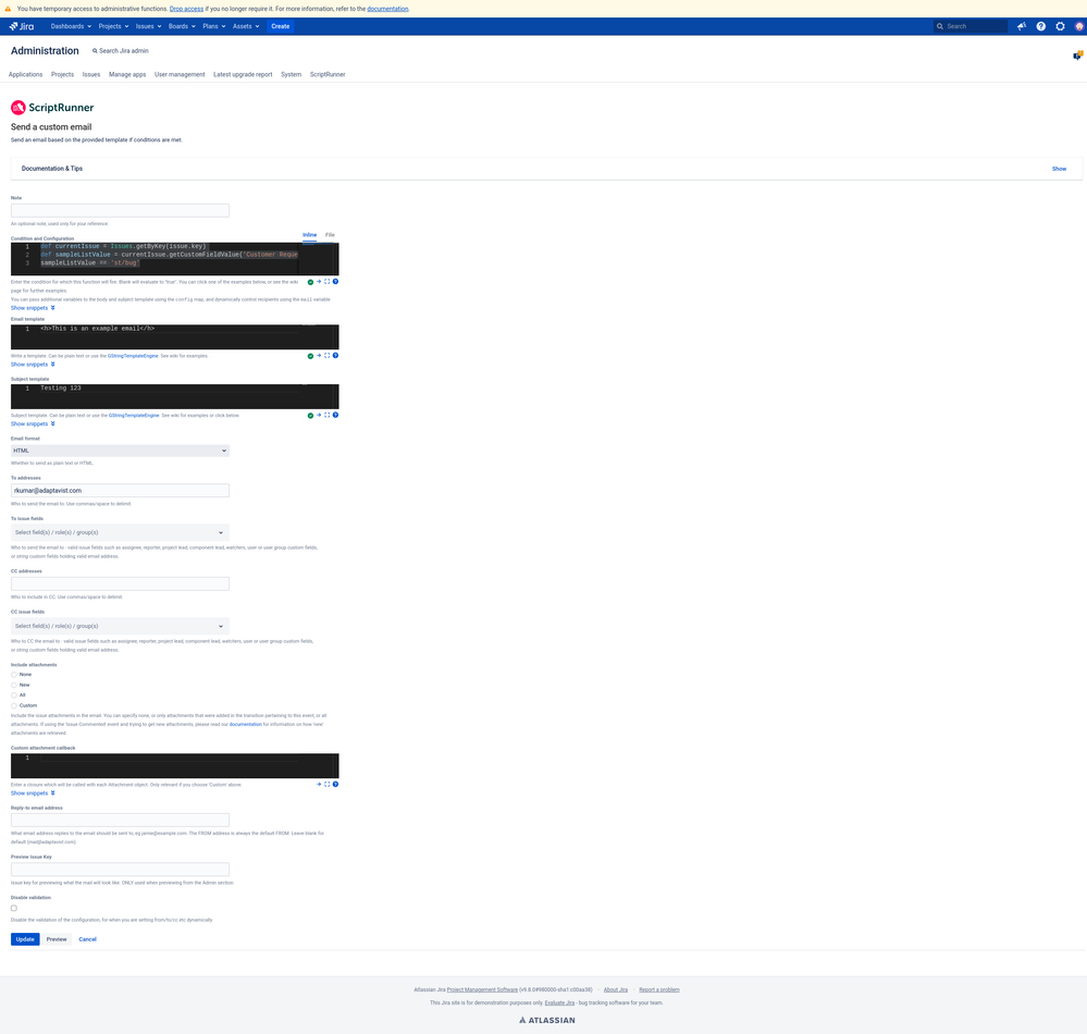

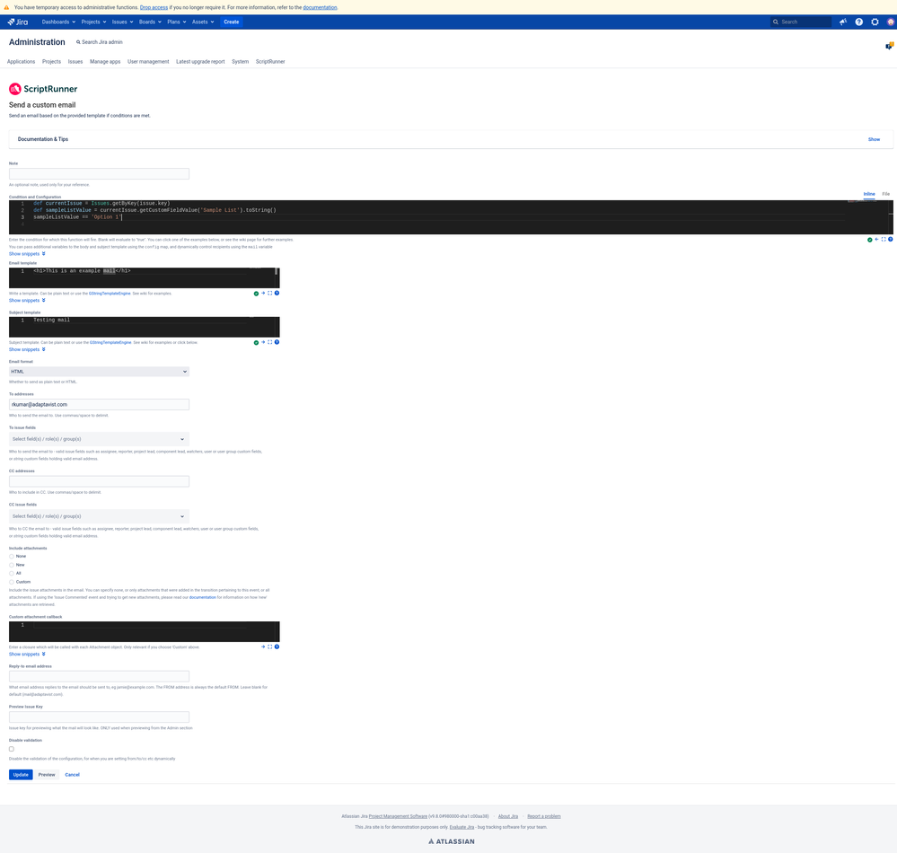

Below is a screenshot of the Post-Function configuration:-
I have run the test using ScriptRunner's HAPI feature.

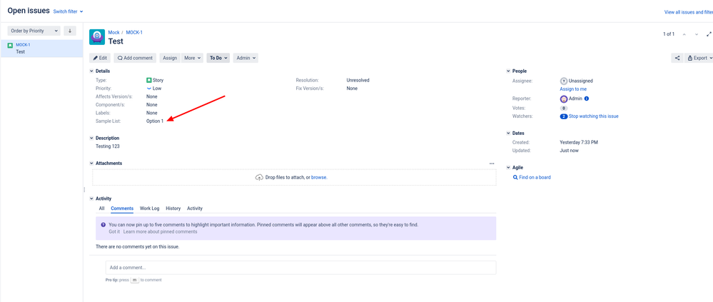

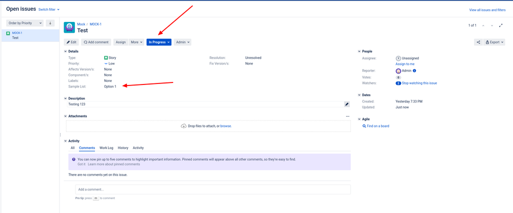

1. Create an issue and set the value for the Sample List field to Option 1, as shown in the screenshot below:-
2. Transition the issue to In Progress as shown in the screenshot below:-test2.png

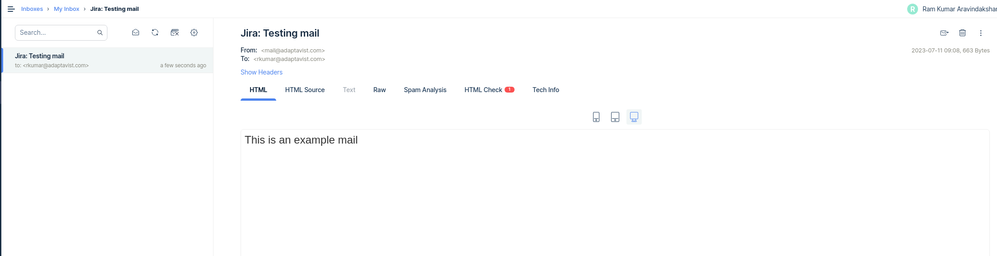

3. As expected, the email is delivered as shown in the screenshot below:-

Below is the sample updated code for your reference:-
def currentIssue = Issues.getByKey(issue.key)
def sampleListValue = currentIssue.getCustomFieldValue('Customer Request Type').toString()
sampleListValue == 'st/bug'
As shown in the updated sample code, update the field name to 'Customer Request Type'.

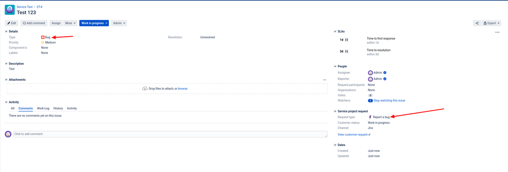

Next, add a check to see what is the value of the Customer Request Type field. So the In the case of testing with a Bug issue type, the value is <ISSUE_KEY>/bug all in lowercase.
In the test above, I am testing with a project called Service Test, and the key is ST. So when adding the condition, I am setting it to st/bug.  You will need to modify this according to the Project and Issue type you are using.
Below is an updated screenshot for your reference:-

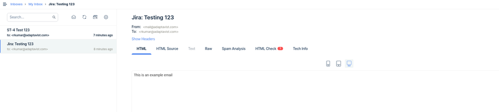

Below is an updated test screenshot:-
The email is also returned as expected:-
