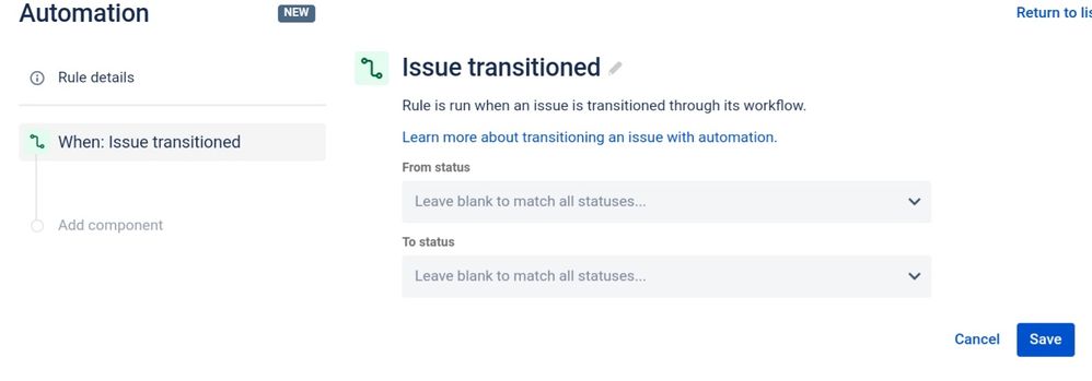

Hello, In this case, if both tickets have the same flows, it is not necessary to do an if else.
In the trigger you can leave the two options blank so that it is executed in all cases.

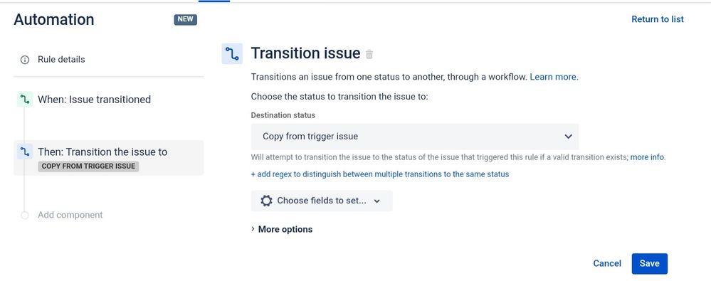

Then within the branch of the related ticket you can select "Copy from trigger issue" so that it goes to the same status as the ticket triggered the automation

@Juan Manuel Ibarra appreciate your response. I tried the exact same thing but got an error:
Action details:
Transition issue
Destination status could not be resolved. If using a smart-value ensure this resolves to a numeric status ID or untranslated name for issues (with current status):
Juan Manuel Ibarra
April 2, 2021
That error seems to be because the flows of both projects do not share a similar status or at least they do not have a way to get to the destination state from the state that is there now. Could you share the workflows?
