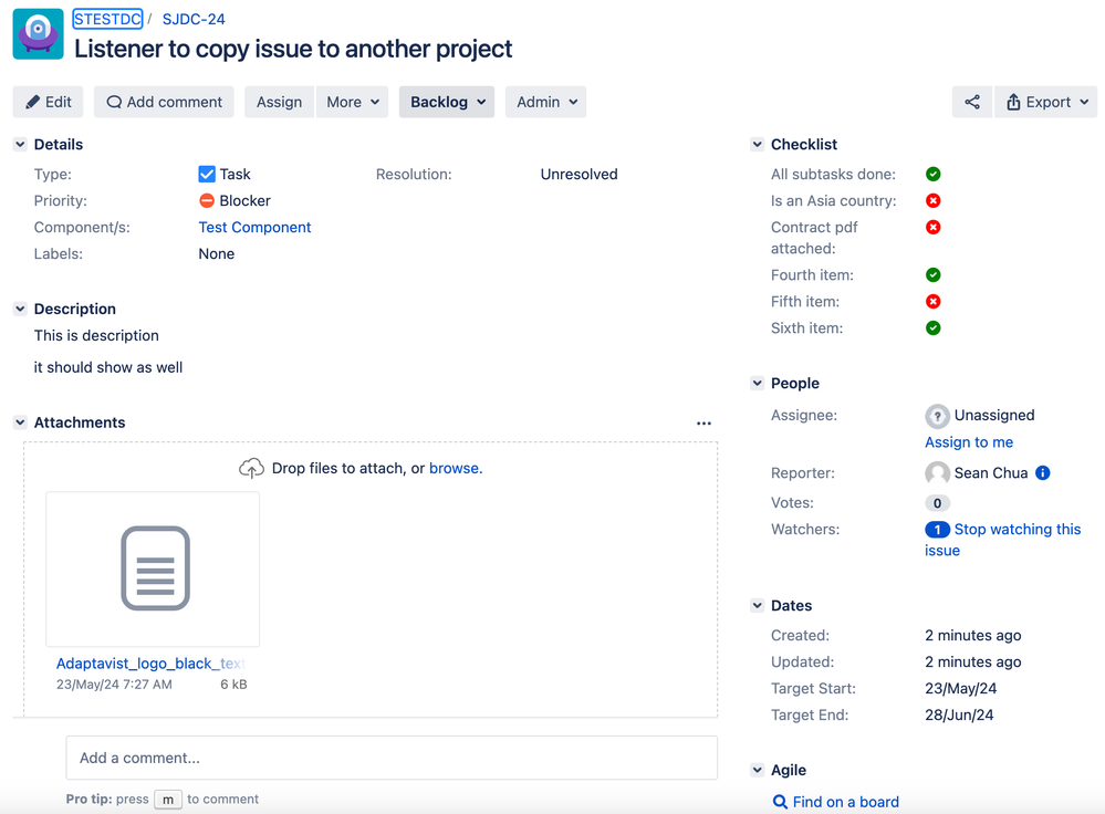

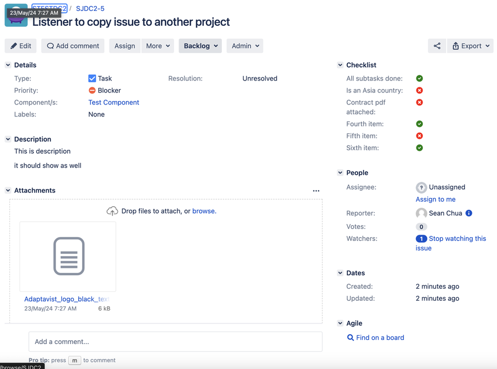

Have you tried using this sample script Copy an Issue to a Separate Project from our Adaptavist Library?
Minimal changes to match my instance and requirements. Created an issue in Project 1, and an issue was copied/cloned into Project 2. The CF (eg: Target Start / End, wasn't copied because the other project didn't have that CF assigned).
Project 1 issue:
Project 2 issue:

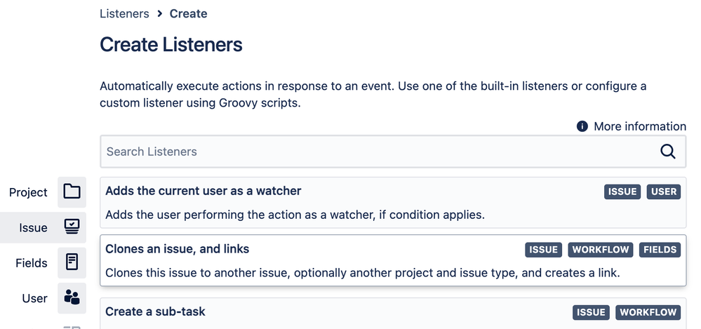

Just for understanding, do you need issues to be created simultaneously into several projects? or perhaps you are looking for like a 1 - 1 kinda thing?
Cause if it is 1-1, then actually using this Built-in Script Listener should meet your needs to clone and link directly. You just need to go over to "Create Listener" , click into "Issues" tab and there is an easy to use UI for you to set it up.
Then if you need further script samples, you can find our Adaptavist Library samples directly from the </>Example Scripts button.

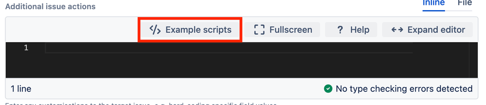

But if you do really do need the script changes itself, you will need to add some code after:
// Execute the clone action with the specified inputs
def updatedExecutionContext = newClonedIssue.execute(inputs, executionContext)
//The issue has been successfully cloned
assert updatedExecutionContext.newIssue
Hope that helps.
