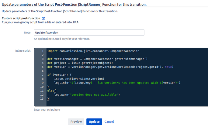

Hi @Arthur Francis,
Below script may work for you, I tested it out in my workflow
import com.atlassian.jira.component.ComponentAccessor
def versionManager = ComponentAccessor.getVersionManager()
def project = issue.getProjectObject()
def version = versionManager.getVersionsUnreleased(project.getId(), true)
if (version) {
issue.setFixVersions(version)
log.info("${issue.key} - fix version/s has been updated with ${version}")
else{
log.warn("Version does not available")
Note: if there are more than one unreleased versions all will be updated to current issue

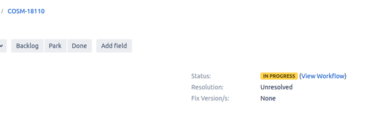

Increasing the log level worked for the output
Time (on server): Fri Jan 31 2020 11:27:15 GMT+0100 (Central European Standard Time)
The following log information was produced by this execution. Use statements like:log.info("...") to record logging information.
2020-01-31 10:27:15,357 WARN [workflow.AbstractScriptWorkflowFunction]: COSM-18110 - fix version/s has been updated with [COSM-20-05]
Says the ticket is updated
But fixversion still says None. I have tried refreshing and editing the ticket to confirm

Leo
January 31, 2020
I think , I got your issue.
What is your post-function order?
Place this post-function on top of everything(I usually do that based on the priority) if not at least on top of generate change history function & re-index post-functions
mostly this would solve your issue
Arthur Francis
January 31, 2020
Thanks @Leo ! this worked for me i moved the update the top of the post-function order
