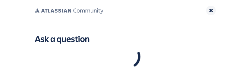

Hmm, odd, what do you mean by "not working"?   The questions portal is the same thing as the discussions, it's just a different type of post in a (hidden) field.  I'm just curious, if you have a problem with Community posts, the Atlassian Community team will want to know, to see if they can fix it.

About the community error, it just keeps loading forever:
I already tried clearing the cache, different browsers (FF, Safari, Chrome, Chrome Mobile) and I have the same issue
