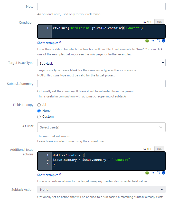

I'm using the Create a sub-task scriptrunner post function.  The only way that I can get it to work is if I set "Fields to copy" to All.
Setting it to None or even Custom causes the post function to fail with the following error in the Logs:

My condition basically searches a multi select field for a specific example:
cfValues["Discipline"]*.value.contains("Concept")
I have the Target Issue Type set to Sub-task.
I have a simple additional issue action to append the name of the discipline to the end of the existing summary:
issue.summary = issue.summary + " Concept"
The only way I can get it to work is to specify that All fields get copied over instead of 'None' or 'Custom'.  This creates a lot of bloat and requires cleanup after creation. Capture.PNG

Updated Scriptrunner to 6.5.0 and it addressed the issue.
