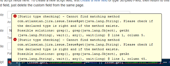

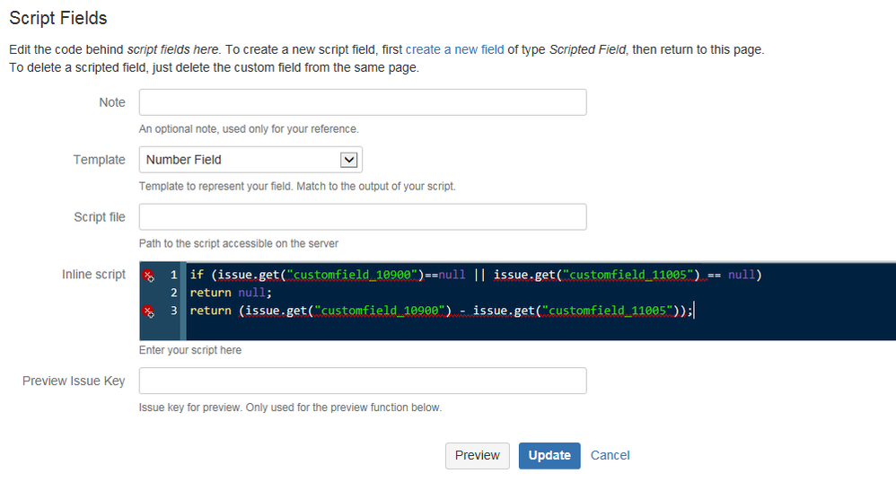

Please help. I need to look at two custom date fields and find the number of days between them.
I've tried multiple ways and times, to get this to work and I've found things on the internet that say this is a 3 line script - others that seem like endless code ?!?!?! What am i missing? Do i need to define more "components" first?  See screen shots below.

The code you have written won't work, here is a snippet that should get you close to the solution, as you need to first get the custom field object and then use this object to get the value from the issue's date custom field
import com.atlassian.jira.component.ComponentAccessor;
import com.atlassian.jira.issue.Issue;
import  java.util.Date.*
def customFieldManager = ComponentAccessor.getCustomFieldManager();
def dateFieldObject= customFieldManager.getCustomFieldObject('customfield_11601');
def dateFieldObject2= customFieldManager.getCustomFieldObject('customfield_11602');
if(issue.getCustomFieldValue(dateFieldObject) && issue.getCustomFieldValue(dateFieldObject2)) {
def dateValue=  issue.getCustomFieldValue(dateFieldObject) as Date
def dateValue2=  issue.getCustomFieldValue(dateFieldObject2) as Date
return dateValue - dateValue2

Cynthia Parenteau
June 12, 2017
Tarun!!!!
Thank you!!! It worked (and on the first try!)  Excellent and much appreciated.
