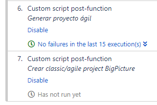

Hello everyone,
I am looking for help hoping someone can support me.
I have 2 workflow scripts and one of them is not running. The first script does a project creation with shared settings and the second one via API creates a project in the BigPicture addon.
When the transition is executed the first script is executed and the second one is not, keeping the message that the script has not run yet.
Does anyone know what could be the reason?

Luis Hernandez
May 30, 2023
Hello @Ram Kumar Aravindakshan _Adaptavist_,
Thanks for your support. I managed to identify the error because it is not running the code to see if you can help me how I can handle the errors. I am getting the value of a customfield but when it is empty it returns a null, how can I prevent the script from failing when this scenario happens?
def boxTypeId = "8"
def projectName = newFinalProjectName
def cfStartDate = customFieldManager.getCustomFieldObject('customfield_14304')
def cfEndDate = customFieldManager.getCustomFieldObject('customfield_14305')
// startDate and endDate returns null and the script fail
def dateStart = currentIssue.getCustomFieldValue(cfStartDate) as Date
def dateEnd = currentIssue.getCustomFieldValue(cfEndDate) as Date
