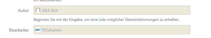

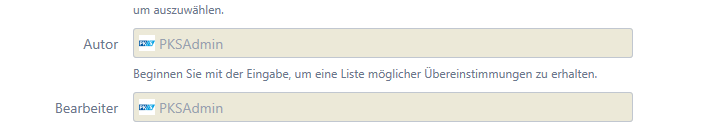

However, the reporter remains the same as the current user.
When I hardcode the reporter to for example "svc_jirabot", it works.
subTaskReporter.setFormValue("svc_jirabot")
The assignee ID gets retrieved successfully so I don't know what's the issue here. Here's an extract of my debug log
[c.o.j.groovy.user.FieldBehaviours] --------------------This is to test Behaviours Logging----------------
[c.o.j.groovy.user.FieldBehaviours] svc_jirabot
Any Ideas?
