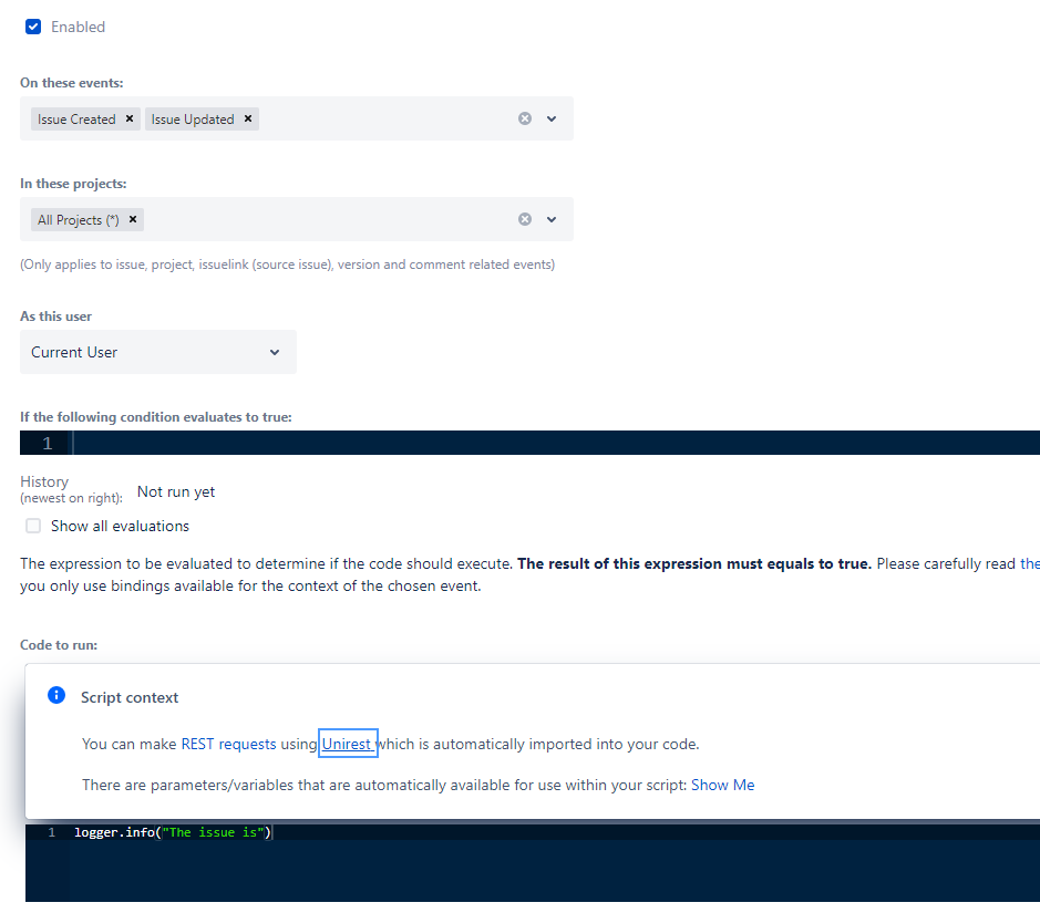

I am trying to run any listeners basically from ScriptRunner on Jira Cloud, I've added the examples but they do not trigger.
I've removed one example and change the other as follows:
- left the condition as: `!!issue.epic && issue.issueType.name != 'Sub-task'`
- updated the script to just log as: `logger.info("The issue is ${issue}")`
The example listeners do not get triggered neither is mine.
Is there any extra step that I need to make in order to get the ScriptRunner listeners basically trigger on Jira issue events?

Ovidiu Ostafi
March 11, 2022
Doesn't seem to fire at all, I have empty condition, the events are Issue Created and Issue Updated, in the script I only have one line of log.
I want to mention that I didn't installed ScriptRunner, it was already installed by previous employees, with that in mind maybe they disabled it somehow in terms of events.
Are there any Jira webhooks that ScriptRunner sets up while installing itself?
I see no webhooks for ScriptRunner in Jira.

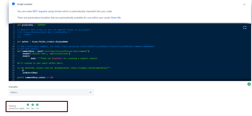

Sachin Dhamale
March 11, 2022
@Ovidiu Ostafi ,
I have tried this and its working fine. If you see at the bottom of page you can see the last run history. I selected the example script to comment on issue and its working fine
If its still not work then try to install plugin again and check
