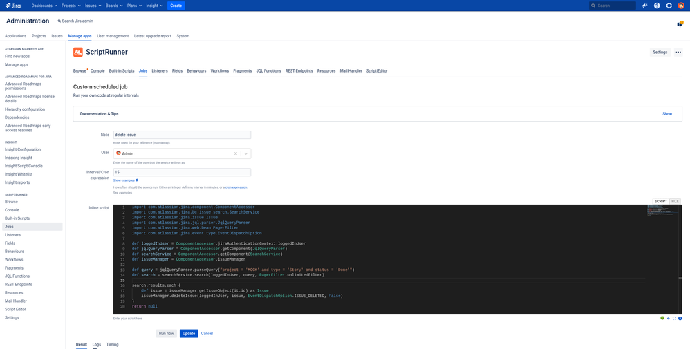

Below is a print screen of the Custom Jobs configuration:-
I hope this helps to answer your question. :)
