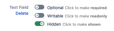

1 - Create a Behaviour and map to a project and issue type.
2 - Add a field 'Code Location' and toggle 'Shown' to make it 'Hidden'
