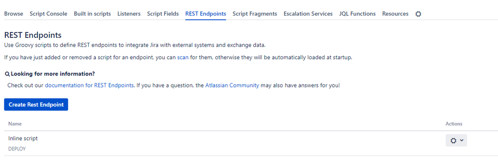

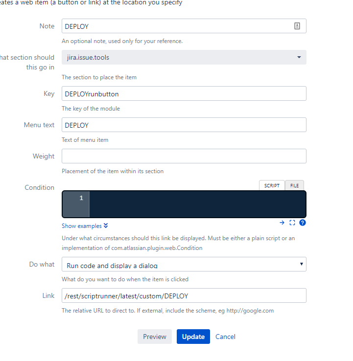

I have created a Jira template with a few custom fields, and with ScriptRunner I have imported a groovy script as REST endpoints
And I have my key button
You are correct, I am not defining any issue, but which one should I define?
Thanks!

PD Sheehan
August 20, 2019
You'll need to pass the issue key in your web item link then parse that out in your rest api.
In web item link, try /rest/scriptrunner/latest/custom/DEPLOY?key=$issue.key

Carmine Fabrizio
August 21, 2019
Hi Peter, thanks for the reply
I've configured

PD Sheehan
August 22, 2019
What does your rest endpoint declaration line look like?
Seems like you've cut that out of the code you shared.
