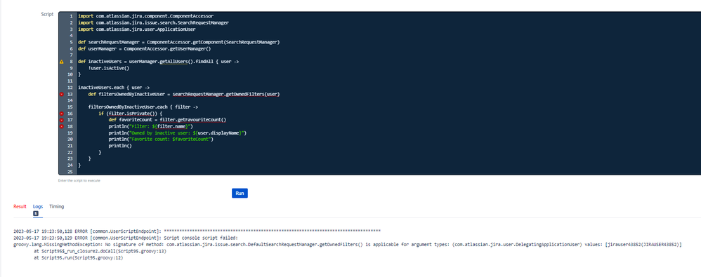

I tried below Script:
But seeing some errors. Could you please help?
CJ Edwards
May 17, 2023
Hi Anuradha,
I would work from the top of the script to narrow the problems.
-  getAllUsers() was deprecated long ago. Use UserSearchService.findUsers() use https://docs.atlassian.com/software/jira/docs/api/9.8.1/com/atlassian/jira/bc/user/search/UserSearchService.html
- for filter work use - com.atlassian.jira.bc.filter - Interface SearchRequestService
https://docs.atlassian.com/software/jira/docs/api/9.8.1/com/atlassian/jira/bc/filter/DefaultSearchRequestService.html
The error listed in your picture is from passing DelegatingApplicationUser instead of ApplicationUser that the function is expecting.
I hope this helps!
