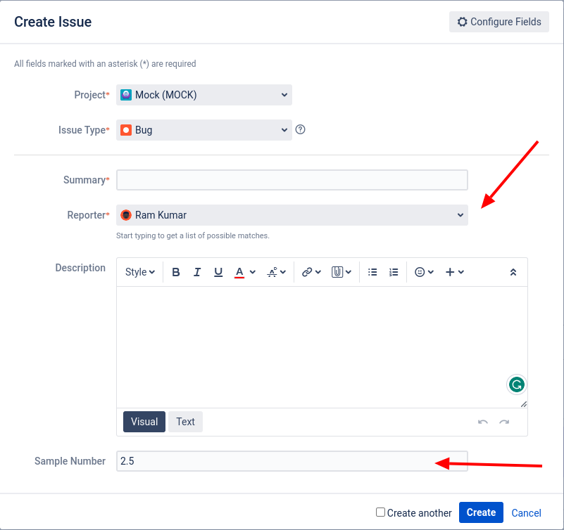

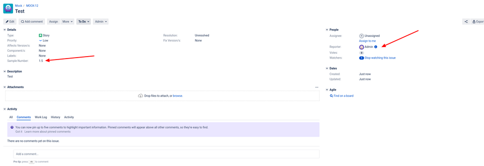

I am also including a couple of test screenshots for your reference:-
1. When a new issue is created, if the user Reporter is set to the user Admin (username is admin), the Sample Number screen is set to the value 1.5.
2. If the user is changed to Ram Kumar (username is ram), as expected, the Sample Number field is updated once again, and the value is changed to 2.5 as shown in the screenshot below:-

Ram Kumar Aravindakshan _Adaptavist_
August 8, 2023
Hi @Humberto Gomes
If you are using Automation, all you have to do for Issue Created / Issue Update is this:-
import com.atlassian.jira.event.type.EventDispatchOption
import com.atlassian.jira.component.ComponentAccessor
import com.atlassian.jira.issue.MutableIssue
def currentIssue = issue as MutableIssue
def reporter = currentIssue.reporter
def customFieldManager = ComponentAccessor.customFieldManager
def issueManager = ComponentAccessor.issueManager
def sampleNumber = customFieldManager.getCustomFieldObjectsByName('Sample Number').first()
if (reporter.emailAddress == 'user1@mail.com') {
currentIssue.setCustomFieldValue(sampleNumber, Double.parseDouble('1.5'))
} else if (reporter.emailAddress == 'user2@mail.com') {
currentIssue.setCustomFieldValue(sampleNumber, Double.parseDouble('2.5'))
issueManager.updateIssue(currentUser, currentIssue, EventDispatchOption.DO_NOT_DISPATCH, false)
Below is a screenshot of the Automation configuration:-
I have tested this code, and it is working in my environment.
Below is a test screenshot for your reference:-
I hope this helps to solve your question. :-)
I am looking forward to your feedback.
Thank you and Kind regards,
Ram
