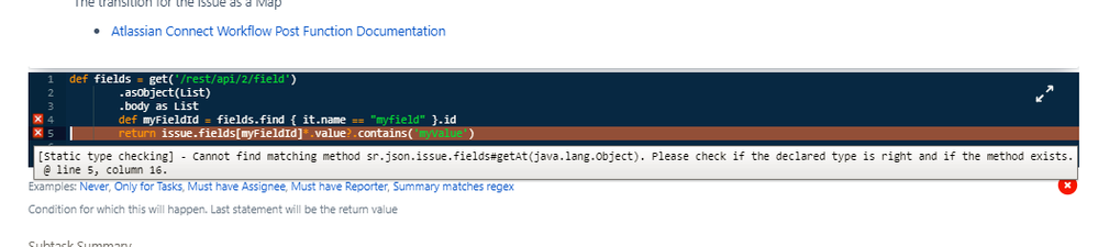

Using this gives me a new error below:
groovy.lang.MissingPropertyException: No such property: issue for class: Script1 at Script1.run(Script1.groovy:8) at com.adaptavist.sr.cloud.events.ScriptExecution.run(ScriptExecution.groovy:22) at ScriptExecution1_groovyProxy.run(Unknown Source)
Static checker says:  "The variable 'issue' is undeclared" at line 8 column 8.
Thanks a lot for your time and help with this!

Hey Jon:  I did run it from the console, however the static checker from the condition dialogue box is still saying "The variable 'issue' is undeclared" at line 8 column 8
I'll try to execute the post function anyways to see if it goes through.

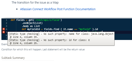

Hi Alan, there are a couple of problems with the static type checking that we're close to having a fix for, so sometimes the messages are misleading. Did this code work in the post function?

Hello @Jon Bevan [Adaptavist] ,
I also have the same requirement, the above code is not working for us. Can you please help here?  I see the errors below :
Thanks,
Swathi
February 15, 2018
Hi Swathi,
Those particular "errors" are actually just limitations of our type-checking system.
You can just ignore them, or make them go away by using the following code:
List<Map<String, Object>> fields = get("/rest/api/2/field")
    .asObject(List)
    .body
String myFieldId = fields.find { it.name == "myfield" }.id
return (issue.fields[myFieldId] as List<Map>)*.value?.contains('myValue')
Thanks,
Jon
