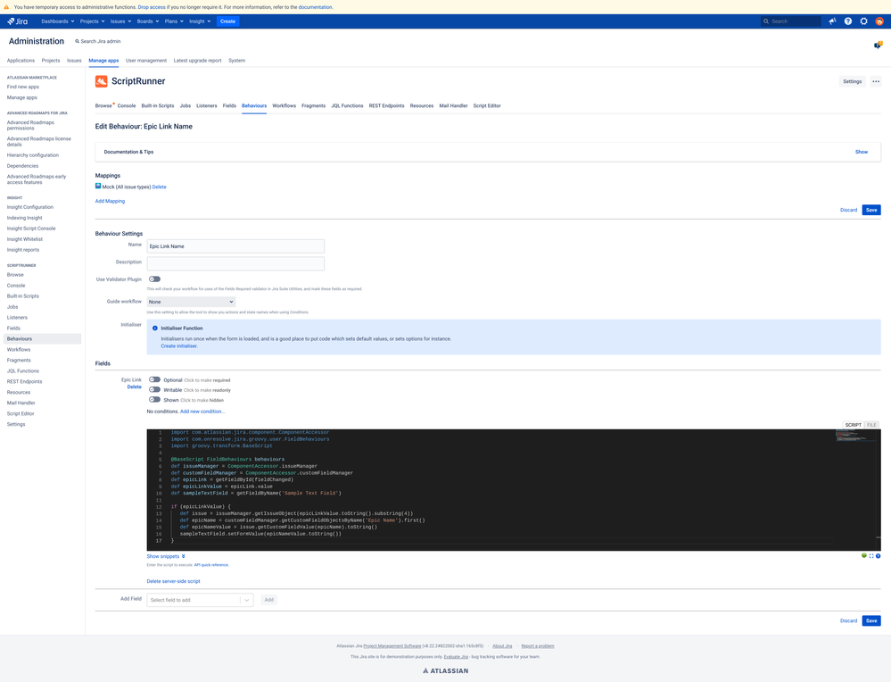

Below is a screenshot of the Behaviour configuration:-

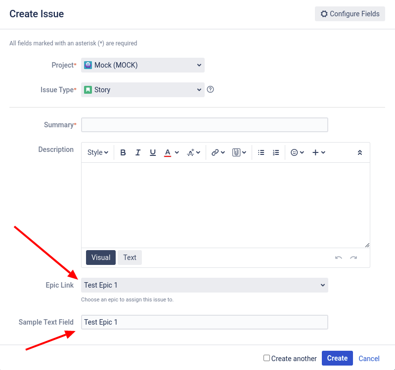

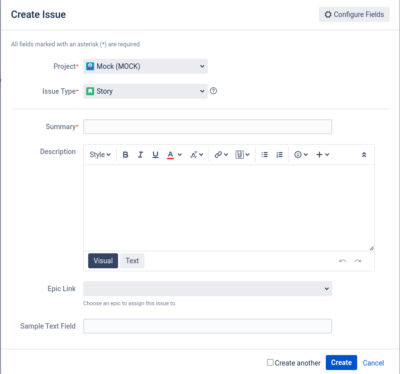

Below is a test screen for your reference:-
1) When the Create dialog first appears, all the fields are empty
2) When I select the Epic Link to Test Epic 1 as expected, the value in the Sample Text Field is updated
3) Similar to step 2, when I select Test Epic 2, the Sample Text Field is updated to Test Epic 2 accordingly.image3.png
