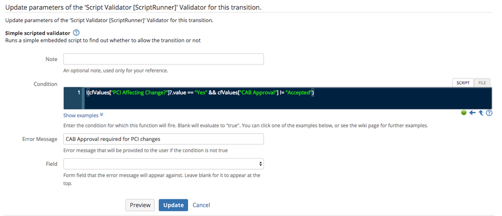

Yes, I've got the && in script correctly.  Attached a screenshot of the setup screen so can check for me being dense! :)
Mark Markov
July 20, 2018
Oh, is this select lists custom fields?
If yes we ve got an error here :)
!(cfValues["PCI Affecting Change?"]?.value == "Yes" && cfValues["CAB Approval"]?.value != "Accepted")
David Nattrass July 20, 2018
Ah ha! I clearly missed that bit of useful information in my original post!
Latest script works perfectly, thanks for all your help!
