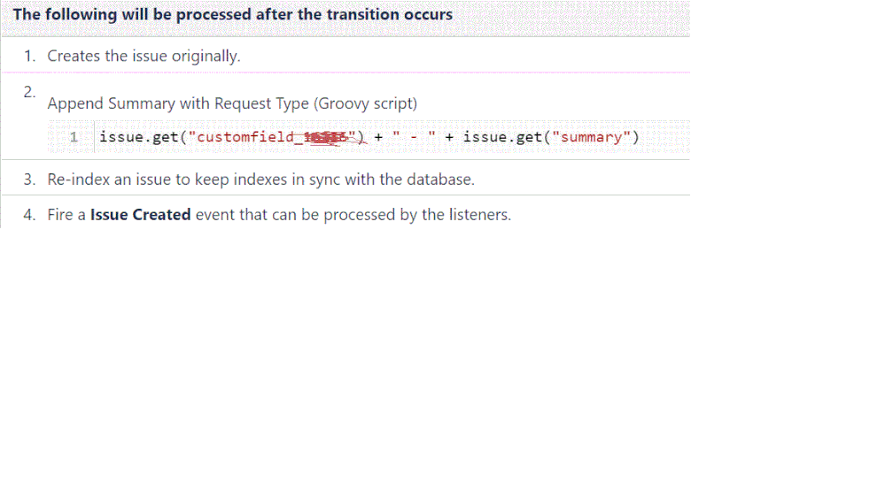

Dear Experts,
I am trying to create a post function using script runner(JMWE) using below script to prefix a custom field value to Summary.
issue.get("customfield_XXX") + " " + issue.get("Summary")
Above script is working fine when testing in post function groovy script console, but not working after publish. I added the post function after create event.
you need to use a Set Field Value post-function, not a Scripted (Groovy) post-function. And place it at the top of the list.

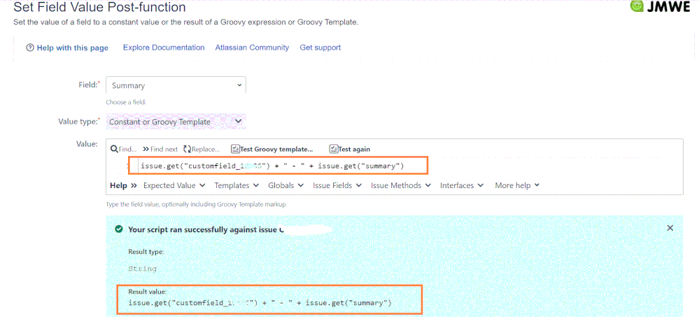

Thanks @David Fischer , Actually I used a set Field post function but the result is displaying as code.
You need to select "Groovy Expression" as the value type, not "Constant or Groovy Template"
Thank you so much @David Fischer . I updated the code below and now it is working.
${issue.get("customfield_XXX")}: ${issue.get("summary")}
