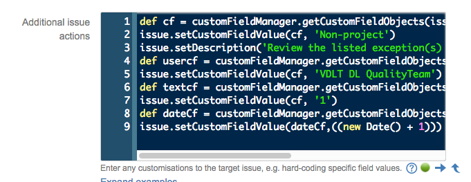

First, did you place that code in the "Additional issue actions box"? It should go in the Additional issue actions box, not the Condition box.

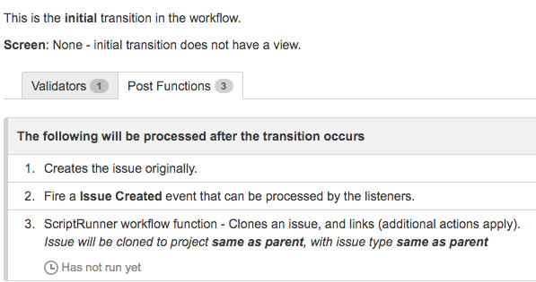

Screen Shot 2017-08-21 at 2.20.52 PM.pngSecondly, did you put the post function in the correct order? Your post function should be the very last thing, like this:
Screen Shot 2017-08-21 at 2.22.46 PM.pngFinally, remember to publish your workflow.

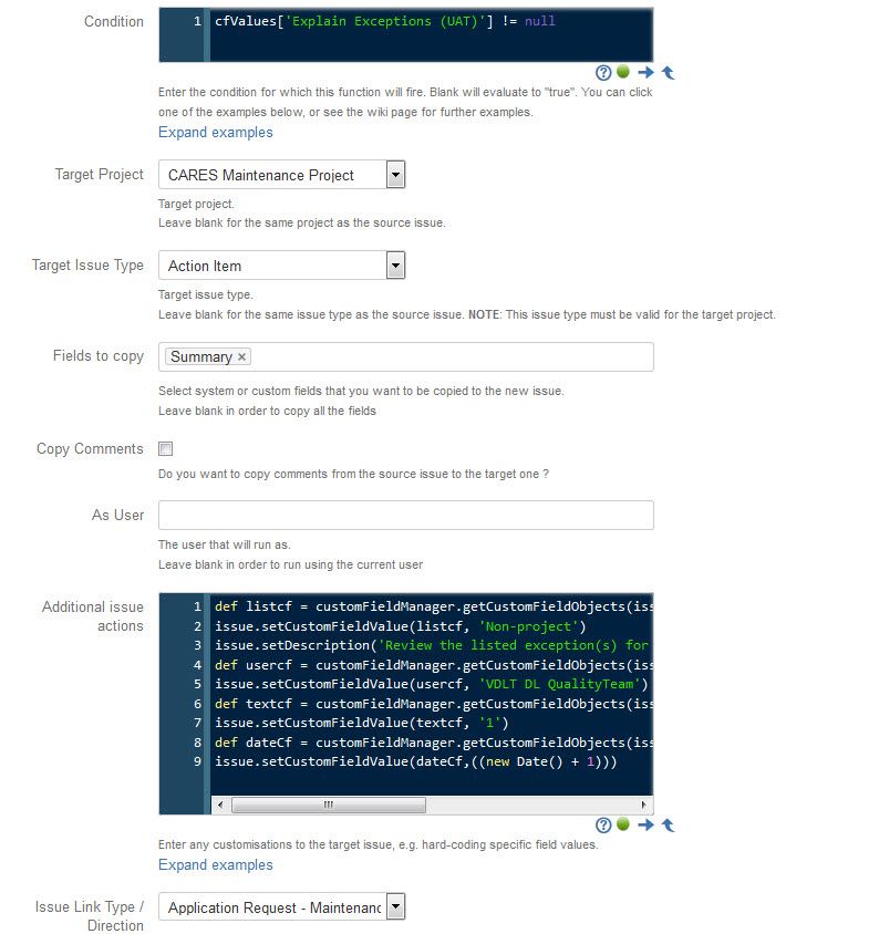

David Willox
August 31, 2017
Hi Joshua,
Still no luck sorry. Here is my setup:
