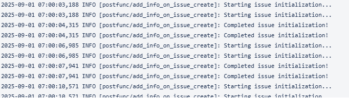

How does it look for job log:

So I found this issue at two different post-function script written by me, both are located between "Add a comment to an issue if one is entered during a transition" and "Update change history for an issue and store the issue in the database" options, Also same bug was found at one of Jobs.
I dont have any scripted fields, First postfunction updates Assets field value and second one assigns an issue to specific user if some conditions passed.
So it is reproduced for quite different cases.
To be honest I don't know how logs could be helpful in this case, nothing changed, any log is recorded twice, please take a look at one more example
2025-09-02 10:03:41,564 WARN [Project.DataToSet]: It's a wrong group, stop
And yes, I use custom logger and it worked perfectly couple if weeks ago
log = Logger.getLogger("Project.DataToSet")
log.setLevel(Level.WARN)
But recently something went wrong.
Thanks for the latest link, I added
log.setAdditivity(false) next to log.setLevel(Level.WARN) and it fixed an issue for one specific script, but now I think and something should be fixed in system settings because in my opinion it's strange to add this string to evert script located in script editor.
