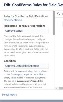

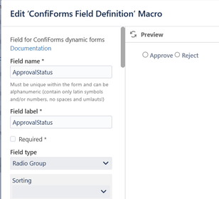

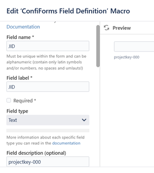

varatha
January 12, 2025
Sure i am try to send soon
Thanks for the quick reply
varatha
January 12, 2025
Hi
I could not find the View storage format option
I have taken the screenshot of my page
Kindly let us know do you  need any more information.
varatha
January 12, 2025

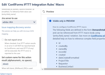

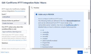

How the IFTTT to create Jira issue is configured?
varatha
January 12, 2025

Alex Medved _ConfiForms_
January 12, 2025

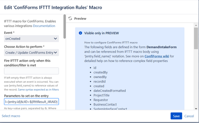

So you have your IFTTT rule to create an issue in Jira to be executed onModified and only when the field "ApprovalStatus" has  certain value, but you configured an IFTTT that should take the result of it to be executed onCreated!?
varatha
January 12, 2025

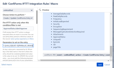

jiraissue.png  No, when modfied form create issue and store jira. Do i need change the event to OnModified? I tried that also.
January 12, 2025
Well, if you want to use the result of that IFTTT then of course you need to run it with the same condition/event and place it after the IFTTT that produces the result
varatha
January 12, 2025

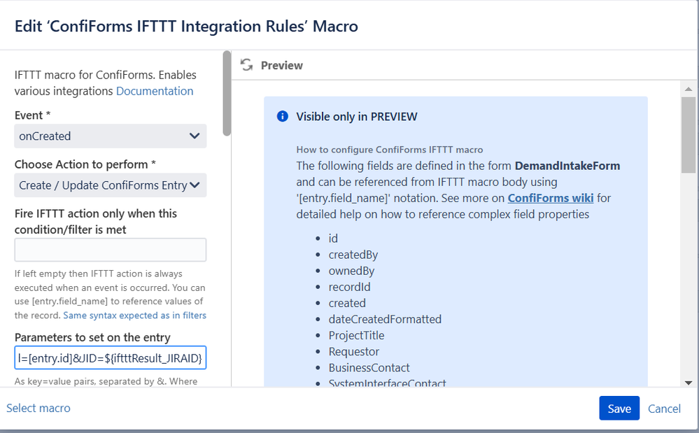

JIrareult-modi.pngHi Alex,
I have used the same event and condition but it does not work. Kindly help
January 12, 2025
Do you have this IFTTT configured AFTER the one that creates the Jira issue?
Does you Jira issue creating IFTTT has a result name set to JIRAID?
May be this simple video will help (although I have tried to answer you earlier multiple times with links to tutorials and videos... kind of a last resort... but I will try - https://wiki.vertuna.com/download/attachments/178782502/Community%20-%20create%20Jira%20issue%20and%20save%20back%20created%20Jira%20issue%20key.mov?version=1&modificationDate=1736681997180&api=v2)

varatha
January 12, 2025
Hi Alex,
Excellent, Appreciated your help. It working now.
But i got "Not option" message with key. Please find the screenshot. Please help.
January 12, 2025
And how do you set the result from the IFTTT that creates a Jira issue? Looks like you set a value with a dollar sign or something
Like varatha likes this
varatha
January 12, 2025
Yes You are right! Now its working properly.
