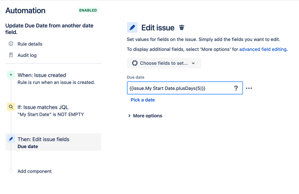

I tested this with a custom field called My Start Date.
The following is my configuration.
Sorry you do not need the {{}} around the custom field. It should be similar to the above to work.

@Nadja Freitas you can then use the field updated event rather than the issue created as your trigger.
The rest of the step would be the same because in my case, I used issue created and set the field value based on this.
The setting part stays the same, you just need to change your trigger.
