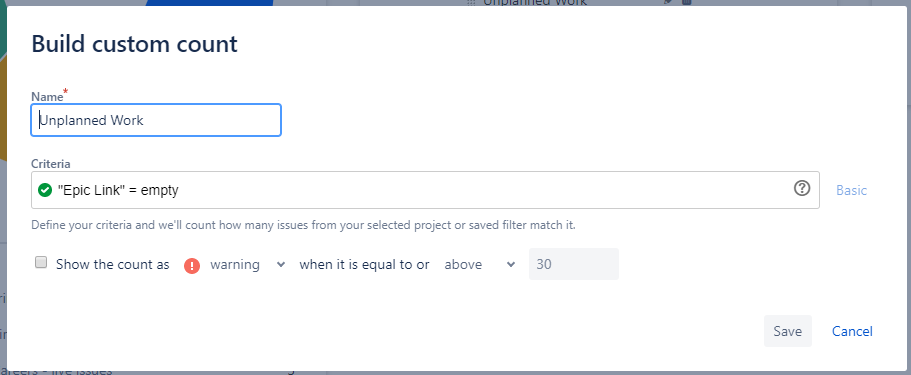

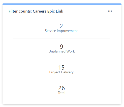

Hi Nic,
Thank you for your message.
I did find a work around with filter count gadget in dashboard that did the job.
Service Improvement = "Epic Link" in (NCSD-180, NCSD-9)
Unplanned Work = "Epic Link" = empty
Project Delivery = "Epic Link" not in (NCSD-180, NCSD-9)
AB
