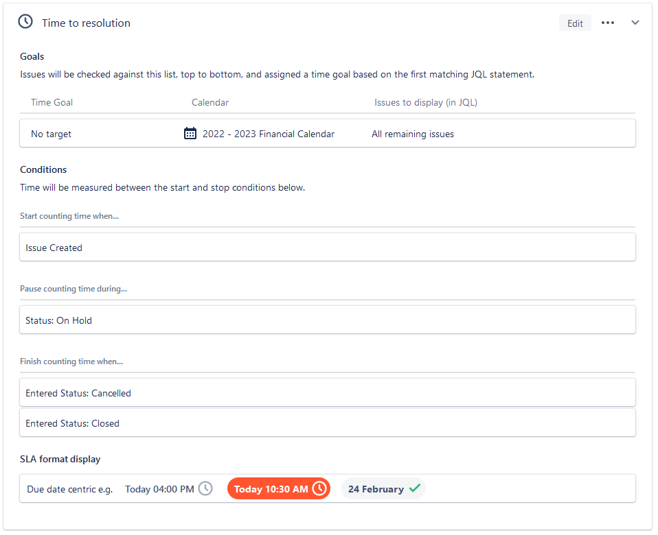

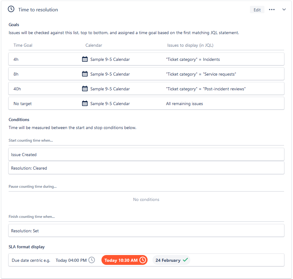

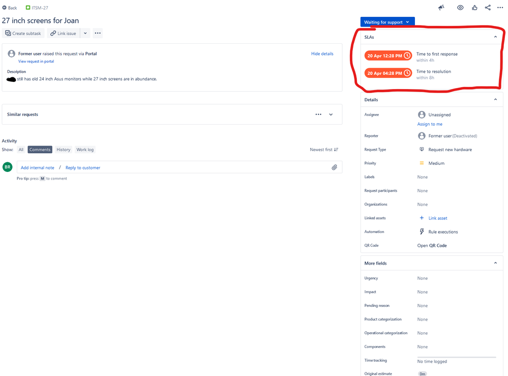

Having a problem with SLAs in Jira Service Management. We currently have two projects spun up, IT Service Management and Action Register, the IT Service Management SLAs are working correctly (and haven't been changed from default) but the Action Register ones aren't showing anywhere (they used to pre and post Workflow changes but then I changed something on the SLA screen and no good).
Attached screenshots show the differences, I do have the SLA fields enabled in the view but they aren't showing up.

For anyone looking for the solution to this it ended up being pretty simple but was due to me missing knowledge.
Basically, I had set No Target in the Time Goal section which means it had nothing to count against. Now, the main knowledge gap was that I though that Time Goal was only for if you were tracking time not date, it works as below.
If you are tracking by date, setting the Time Goal section will make it so it tracks "the time you need to have this done within (x) time of the due date"
When I filled in the Time Goal section, everything started working as intended.
