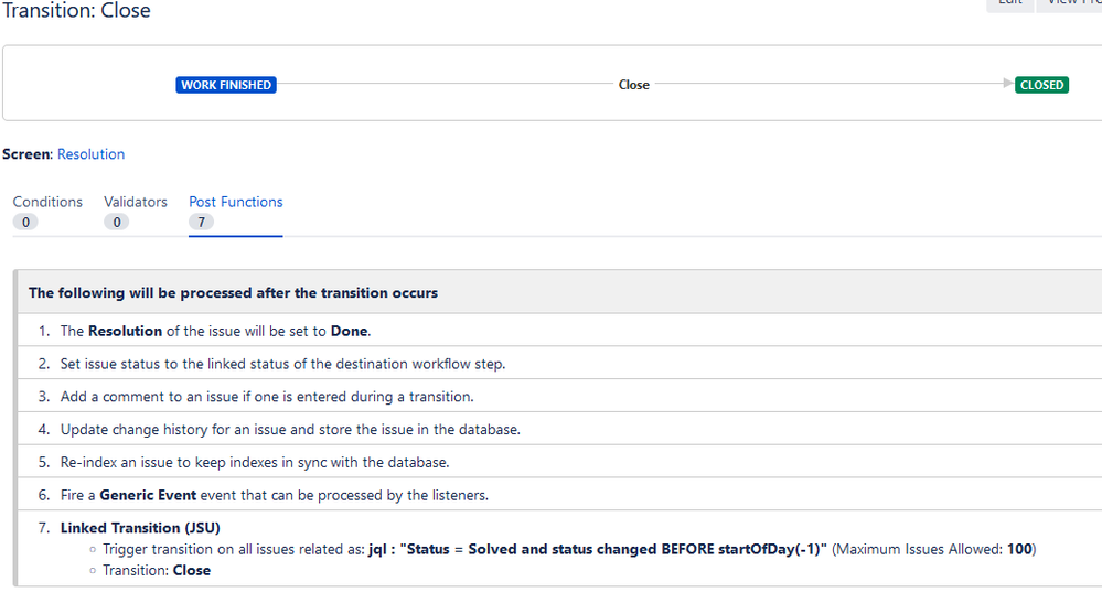

kousalya palagulla
February 7, 2023
Hey Mark,
I put the post function in the workflow with the mentioned query, but the tickets still remained in the solved state and did not go to the closed. Below is the screenshot
May be i did something wrong, could you please suggest, thank you in advance
BR,
Kousalya.
Mark Segall
February 7, 2023
Doing this as a post-function won't work because the post-function will only serve what's going on in that moment.  What I proposed was using the Jira Automation marketplace add on.
https://marketplace.atlassian.com/apps/1211836/automation-for-jira-server-lite?hosting=server&tab=overview
