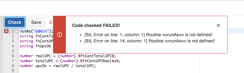

I'm Sorry Alexey, but it's in Jira CLOUD and the checker gives me errors:

That is right, This method is not available for Cloud. I asked cPrime about it. I will let you know when I get an answer.
