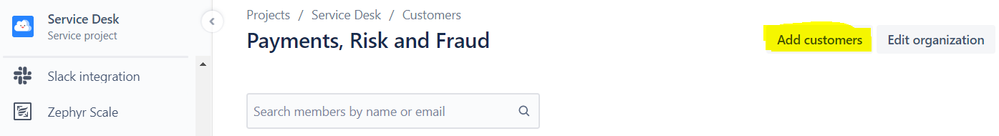

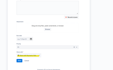

Hello team,
Essentially we want to configure someone's new account with this option.
However, it only gets this;
I have checked both profiles on Admin and they look the same, what am I missing?
Thanks in advance

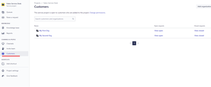

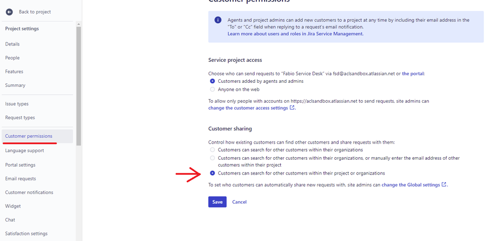

Hi @Abelardo Contreras ,
first of all, at your project setting level, could you check thsi setting?
Do you have organization configured in your project?
Hope this helps,
Fabio

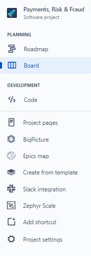

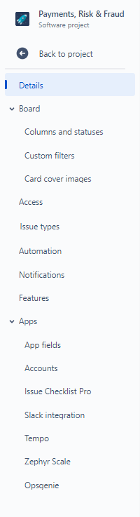

Hello Fabio,
Thanks for your reply. That's the thing, I don't have those options
The other thing I am wondering, it is actually a configuration project thing or a user thing? As a few users can do it and others can not.
Again thanks for your time
Abel
Fabio Racobaldo _Catworkx_
April 11, 2022
the problem is that you are trying to setup that behaviour on a JIRA Software project and not on a JIRA Service Management project. Please check the project type in the project settings details.
This should explain your doubt.
Fabio
In order to avoid confusion. Share with is a field that appears on customer portal side so customer can share requests with other users/organization. Portal is an option related just to JIRA Service Management project.
At JIRA Software project, in order to manage sharing, you can add Watcher field in creation screen, check users that can add watchers through the project permission scheme and verify Global Permission "Browse users". Doing that, on creation, users can add other users as watcher of their tickets.
Hope this clarifies your doubt.
Fabio
