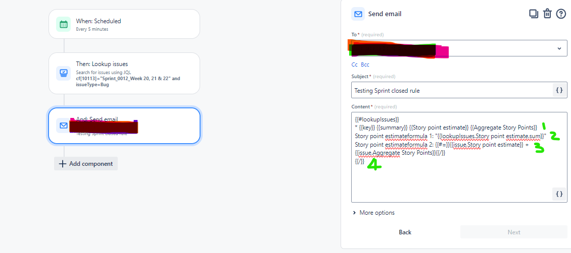

Attached is the Screen shot of the Automation rule.
Here's what the automation rule looks like
Line 1 : I am printing the values of the fields before using the summation formula in lines 2 and 3.
The values are as printing correctly for
Key, Summary, Story point estimate and Aggregated Story points
Line 2: I am trying to add values for Custom fields using up lookupissues - THIS IS NOT working
Line 3: I am trying to add values for Custom fields using a diff way. - That's NOT working either
Line 4: Closing braces for lookup issues.
The ideal formula would be to update the Aggregate Story points (custom field) with values from Story point estimate (for Issue 1 and Issue 2)
Aggregate Story points = issue1.Story point estimate + issue2.Story point estimate
Not sure if this is a syntax error or fundamentally wrong in the way I am trying to solve this problem.
Any help would be greatly appreciated.
Thanks
KD

Trudy Claspill
July 1, 2024
Hello @Dipen
For line 3 try removing the issue. prefix from both smart values. Because you are trying to access those values from within the block that is iterating through the lookupIssues results, it infers that you are wanting the information for the current issue being printed from that results set. So you don't have to include the issue object reference, just like you didn't include it when you printed the key or summary.
I suspect line 2 is not working because you have it within the block that is iterating through the issues in the lookup list. Again, like above, and field references within that block are inferred to be a reference to the current issue being printed from the results set. Since the value you want is not for a specific instance but rather is a sum across the entire result set, you need to extract that line. I think it would work if you put it either before the {{#lookupIssues}} line, or after line 4.

This is what implemented
Story point estimateformula 1: "{{lookupIssues.Story point estimate.sum}}"
{{#lookupIssues}}
* {{key}} {{summary}} {{Story point estimate}} {{Aggregate Story Points}}
Story point estimateformula 2: {{#=}}{{Story point estimate}} +{{Aggregate Story Points}}{{/}}
and I am not getting the error any more.
Working on evaluating the total's to make sure I am getting the correct values. Will keep you posted.
Thank you once again
KD

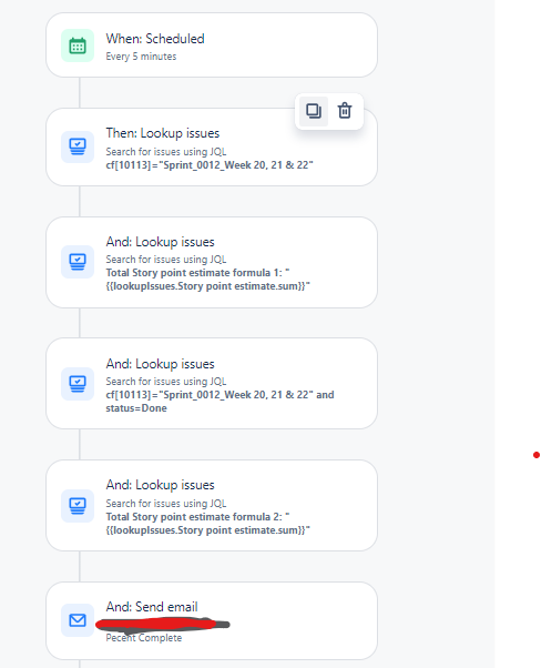

This is the rule I have in mind that I am testing with
%complete = (total story point estimate formula 1/ total story point estimate formula 2) *100
Thanks
