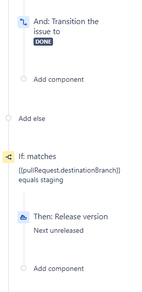

Here is a very common scenario:

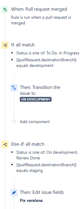

If a pull request is merged I would like to transition all issues mentioned in the pull request to a new status, set the fix version and afterwards release the version,
This automation rule is triggered once for each referenced issue. All issues are tagged with the correct fix version and are transitioned to done, this part is working fine.
My problem is that after this rule has completed I would like to release the version automatically, If I add a new block at the end like shown above it will attempt to release the version for each issue that triggered the rule.
Question: How can I transition all issues in a pull request and just have it trigger the release version just one time for the pull request after the above automation has completed?

First thing...I see two conditions are checking if the PR destination branch is staging, and one of them is outside of your if/else conditions.  Is that correct for your scenario?
Back to your question...One way to do this is to use lookup issues and JQL to drive this with the function earliestUnreleasedVersion() ...such as this:
  • ...your rule steps
  • your condition to test if the PR destination branch is staging plus any adjustments you may make (see above)
  • action: lookup issues with JQL to find the issues in the earliest unreleased version
    • project = yourProjectName AND fixVersion = earliestUnreleasedVersion(yourProjectName)
  • action: release version, using the fixVersion name from the first issue in the lookup
    • {{lookupIssues.first.fixVersion.name}}
One more...when posting images of rules for questions, consider using a browser addon or screen capture which supports scrolling.  That can help to have the entire rule in one image for context.

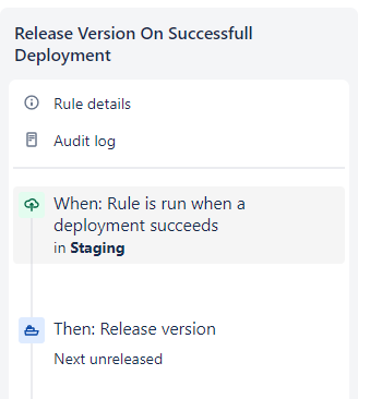

thank you for your response, the additional check outside of the original branch was just to do some tests. Since I removed the lower condition and moved it to a different rule in order to trigger the release once a pipeline finished it's execution.

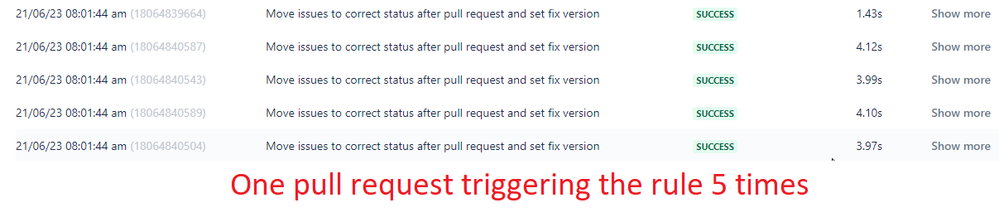

After my last deployment this pipeline ran for each issue associated with the pull request:

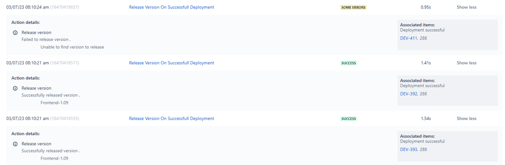

wouldn't this still trigger the automation rule multiple times and just lead to the same race condition between releasing the version and creating a new on in a different trigger?
Simply put, how can I release a version after a pipeline has succeeded or alternatively a pull request has been sucessfully merged.
This shouldn't be a hard task, I just miss something elementary here.
