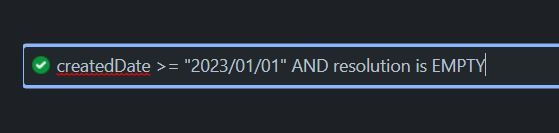

That being said you can run a Scheduled automation and make the JQL look at a date field like created date or updated date and then that also has the requiredfield IS Empty
something like this:

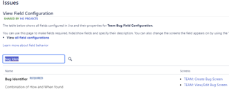

RE:  "some mandatory fields on create"  meaning I have field configuration of required on the create workflow -  yes.
Attached are screen shots of field configuration and field defaults.  The field is marked required, the option of None still appears, cloning of issues where the value is None does not prompt for the value to be updated.  None seems to be accepted as a valid value to satisfy the required rule.  I also did not add None as an option.

Cassie the Jira Mechanic
August 21, 2023
@Penny H-D Looking at yours it appears there is not a default value.  This will remove the ability to have "None".  The only way out-of-the-box for Jira Cloud to remove "None"  is to mark the field as Required and with a Default Value.
