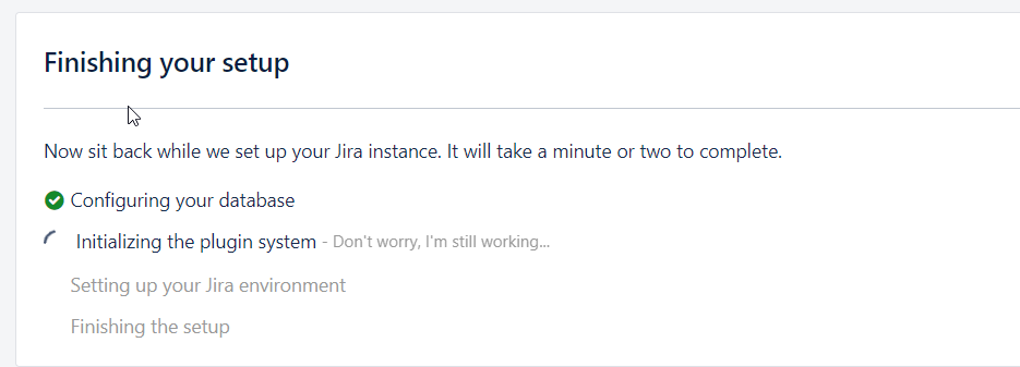

The only thing I notice is that the simple original instance of Jira running locally start and init fast.
When run in azure the same image without any change take a long of time, the simple plug in initialisation takes roughtly 1 hour and during that time you get the picture below :
I satrt it at 1h30 and it is still not complete, the log is moving slowly, slowly
wierd

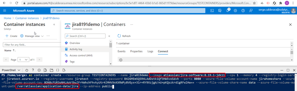

here is the command used to pull the atlassian image on Container Instance with volume mapping:
Charlie Misonne
October 15, 2021
The data directory of Jira must be on a fast disk. It contains indexes and caching. If you mount it over SMB it will be too slow. I think that's why you are encountering this performance issue.
Can't you use a local disk?
I have no experience with  Azure Container Instances so I'm not sure whether this is supported.
