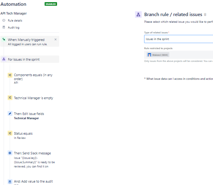

I want to trigger an automation rule manually to scan all issues in the active sprint to check its fields values and update them accordingly
I created a manually triggered automation rule , and added For All Issues in the Sprint
I didn't know how and from where I can run it!!!
I tried running it from a subtask or a story within the concerned sprint... but I got this error:
Action details:
This rule was configured with a project restriction.
You can change this restriction in the 'Rule details' section.
Only issues from the following projects or project types will be considered:WAK
Branch rule / related issues
Can't branch rule as it requires a sprint in the context for this option.

Can you share the filter that is used in the board and also the actual details of your automation rule?
Ibrahim Ghalghay
June 27, 2021
Dear @Fabian Lim ,
thanks for your answer
no filter is used in the board,
and here are two screenshots for the automation rule
Kevin Bui
June 28, 2021
Hi @Ibrahim Ghalghay - For your branch to work, you'll need to use one of the Sprint triggers - either Sprint createdSprint started, or Sprint completed. This is because without a sprint trigger, your Automation rule can't know which sprint to look into.
Hope that helps!
