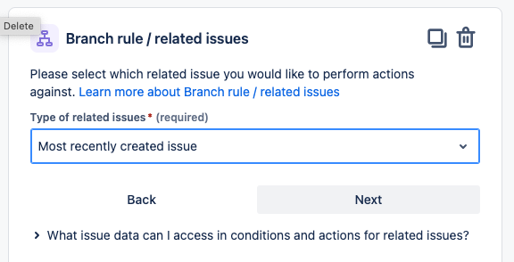

In the same rule you can use branch item and set it to 'most recently created issue' and inside branch add comment action.

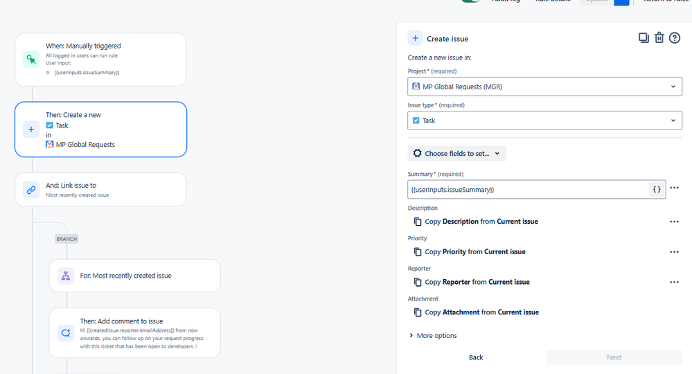

Hi Sebastian, I tried but no comment is added in the new created ticket:

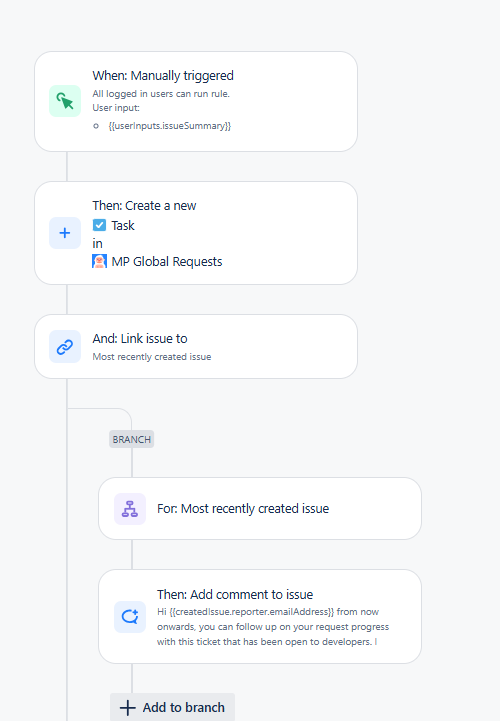

Hi Bill, thanks for answering :)
I add the answers here:
  • what type of project is this (e.g., company-managed, team-managed, etc.), I would say is team managed
  • an image of your complete automation rule in a single image for continuity,
  • images of any relevant actions / conditions / branches,
  • an image of the audit log details showing the rule execution  (I'm lost here, I dont know where to find that)
  • explain what is not working as expected and why you believe that to be the case.
In the new ticket that is created thank to the above rule, I'd like to have an automation (within the existing rule) that adds a comment.
In this comment I'd like to name @ the reporter, which thanks to the automation before is the same as in the first jira (the original one, where the automations starts)
I tried doing the branch process, but I do not get the comment.
Example of the branch:

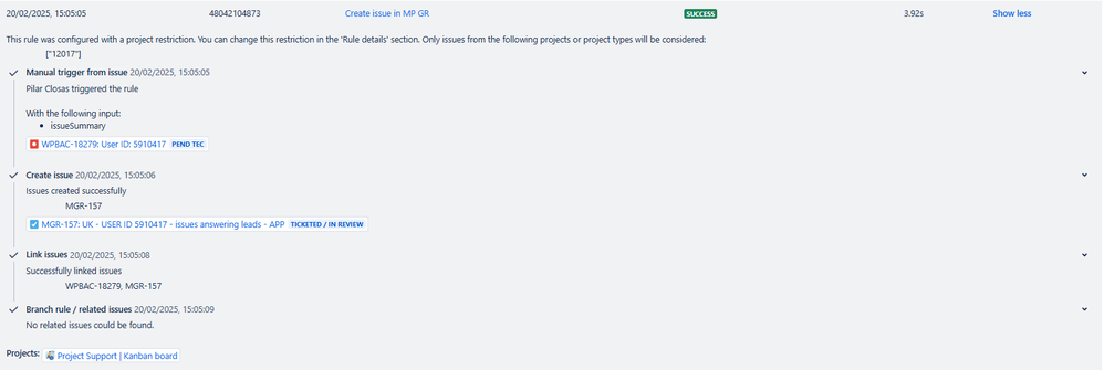

To find the audit log and post the image...
  • while in the rule editor, select Audit Log at the top-right
  • find the specific recent execution, and select Show More at the right
  • also on the right, expand the areas so all the detail show
  • capture and post the image

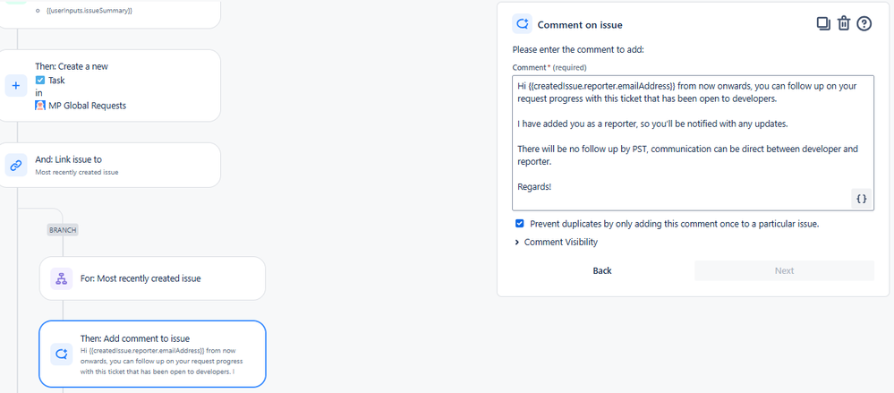

In the comment, if you want to mention the reporter so they get notified, replace the email address information in the comment body with this:
[~accountId:{{createdIssue.reporter.accountId}}]

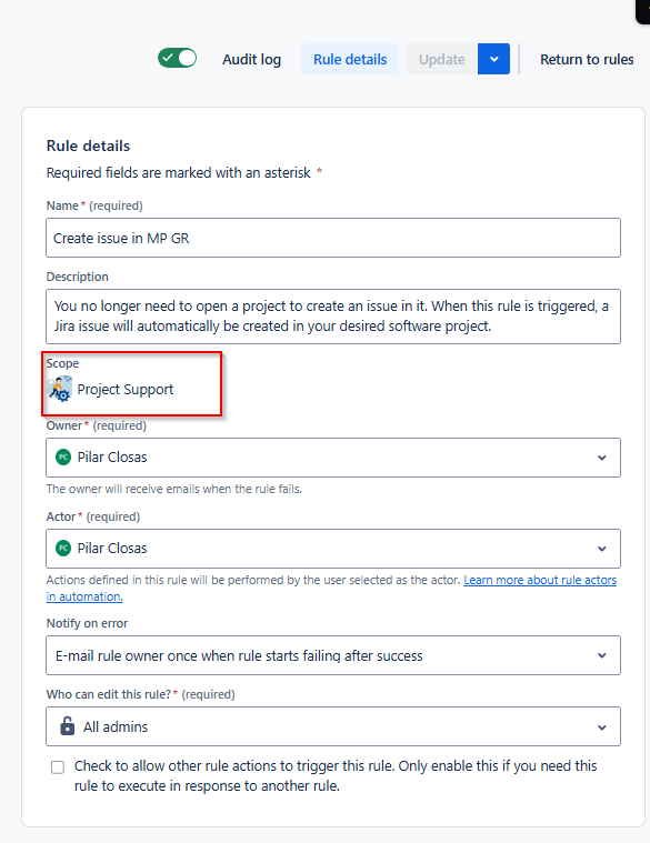

Also, please note my question about the rule scope.  If your rule is single-project scope, it cannot add a comment to an issue created in a different project.
Instead the rule must be changed to at least multiple-project scope.

I checked the audit log:
and the scope:
I will contact my Jira Admin to see if I can get the scope issue solved.
