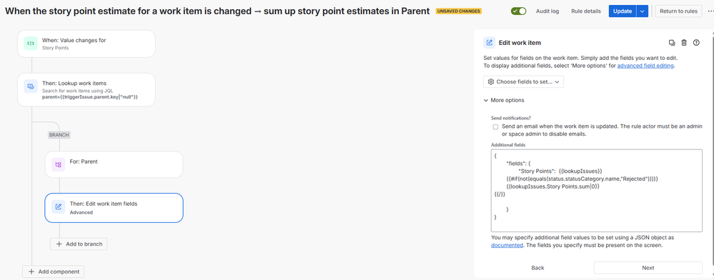

I would really appreciate it if someone could help me setup an automation to sum up Story points of work items to parent with the logical condition that the work item is not in status Done
I am using a company based project and I am using this smart value operation:
{{#lookupIssues}} {{#if(not(equals(status.statusCategory.name,"Done")))}} {{lookupIssues.Story Points.sum|0}} {{/}}
Thanks!

Thanks @Trudy P Claspill !
The Story Points field does not update at all although the Audit log suggests that the automation was successful

What are you trying to do with the second step in your rule?
Let me see if I understand your Requirement
For example if you have the following set of issues:
Epic-1
--- Child-1, status To Do
--- Child-2, status In Progress
--- Child-3, status Done
--- Child-4, status Done
If the Story points change on Child-4, you want to add up the story points for Child-1 and Child-2 only (because their statuses are not Done) and update Epic-1 with that value.
Is that correct?
If that is correct I recommend you simply the rule thus:
TRIGGER: keep this as is
FOR EACH: Parent
ACTION: Lookup Issues
JQL: parent = {{issue.key}} and status != Done
ACTION: Edit Work item
Field: Story Points
Value: {{lookupIssues.Story Points.sum|0}}
I see that in the image of your rule you used Rejected rather than Done. Make sure you change the JQL in my suggested solution accordingly.
Thanks! It seems to work as intended!
I don't understand how though :)
I would have guessed that the JQL would return the parent of the issue who's story points field was changed and who's status was not done?
You didn't explain how you came to that conclusion, but I'll try to explain the logic of the JQL.
When you use "parent = X" you are telling Jira you want the issues whose parent is X.
When you are within a branch the context of {{issue}} changes. It no longer references the issue that triggered the automation. Instead it references the issue(s) being looped over by the branch. In this case because the branch is For Each Parent (of the trigger issue), within the branch {{issue}} references the parent of the trigger issue.
So, when story points change for Child-1 the branch begins a loop for the parent of Child-1; namely Epic-1.
Within the branch {{issue}} now references Epic-1. The JQL says to find issues where the Parent field equals Epic-1, meaning find the child issues of Epic-1, and additionally says to get only the child issues whose status is not Done.
Does that help clear things up?
