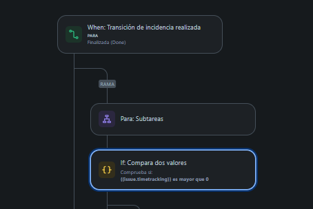

Rule for close a subtask only when the registered time its superior to 0
Enmanuel Vignoli
June 28, 2024
my principal idea was to use the Issue Transitioned trigger, then set a branch for Subtask and add a condition with time traking > 0 with a For in For
2 votes
Trudy Claspill
June 28, 2024
Hello @Enmanuel Vignoli
If you want to evaluate the amount of time logged against an issue you need to use this smart value:
{{issue.timetracking.timespent}}
...not this smart value:
{{issue.timetracking}}
Which issue are you trying to affect with the second branch? Are you trying to affect the subtask or the parent of the subtask?

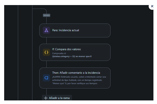

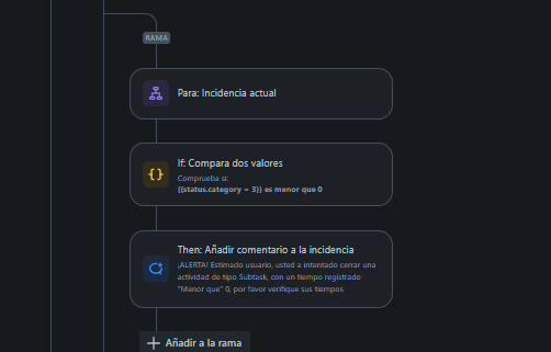

The way the rule is currently written it will be triggered when an issue of any type transitions to Done.
Next it will step through the Subtasks under that issue. If there are no subtasks then no actions will be taken.
For each subtask I assume that you want to check if time has been logged against the subtasks.
I am unclear what you want to do after that. I can tell that you want to check the Status Category of the Status assigned to an issue, but I am not sure which issue you want to apply that to. It appears that if the Status Category is Done then you want to add a comment to the same issue.
